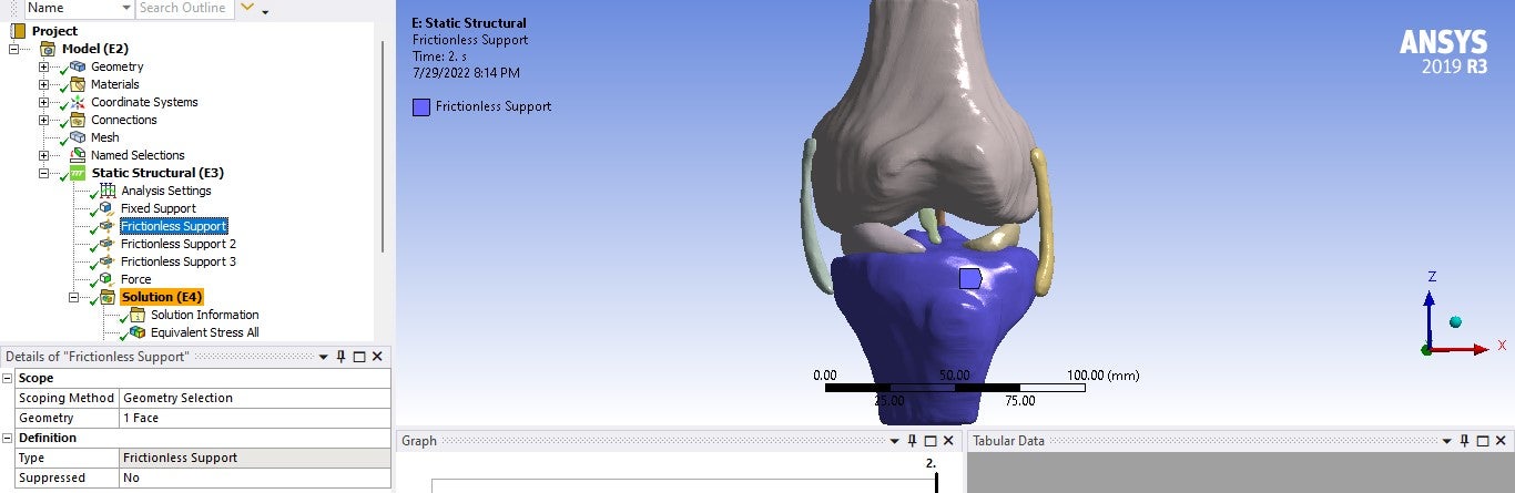

I have some issues simulating the human knee joint behavior. I had asked some questions about them before, but i got no response.

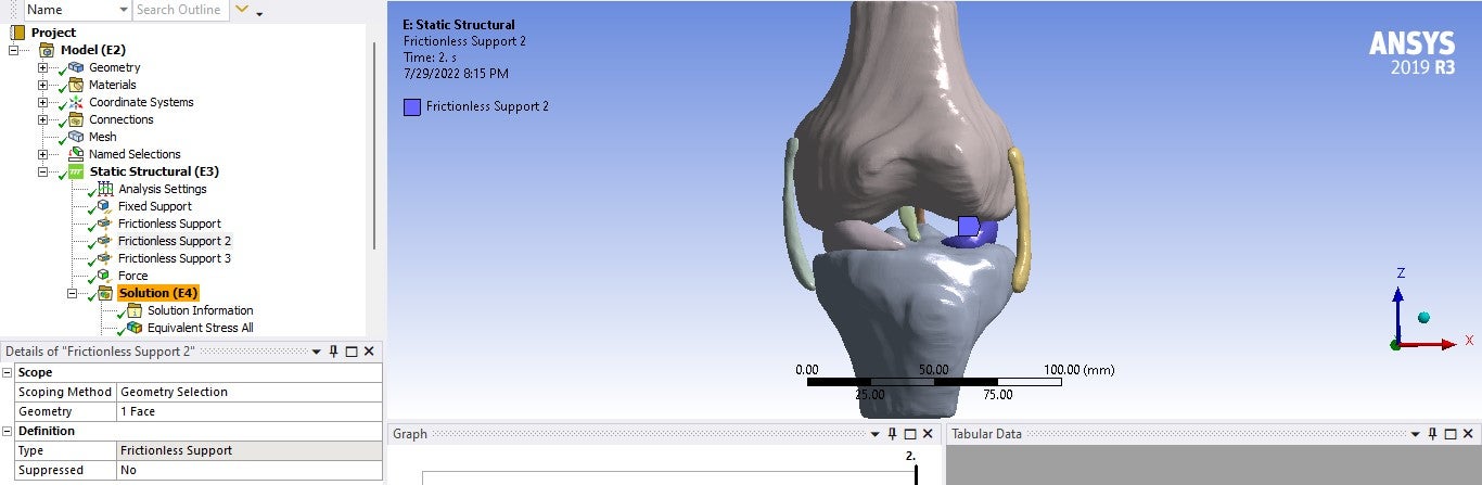

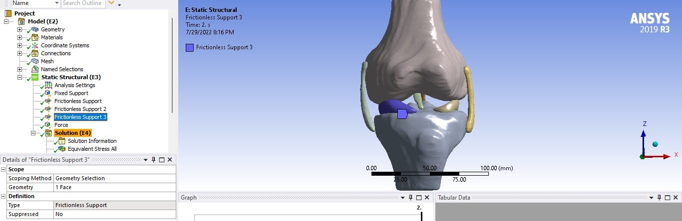

Referring to the question thread that you posted, I can see you have used frictionless support, where frictionless contact is specified.
One thing to note here is that Frictionless Support is not equivalent to Frictionless Contact. To know more about frictionless support refer to this link:
Frictionless Support (ansys.com)
Meanwhile, can you share images showing the faces where you used frictionless support for more clarity on the boundary conditions applied by you?
Also, are you using the Ansys Student version to carry out this analysis?Regards,

For the problem mentioned above, The usage of frictional support here won’t help and would only make the system over-constraint leading to much higher stresses than actually what it should be. Can you try using different boundary conditions here, like using frictionless contact between the bones?

August 3, 2022 at 10:09 am
OmidNazeri1997
SubscriberDear Saumadeep.
Thank you for your help. As you mentioned, i removed the frictionless supports and the results are now exactly similar in terms of order.
I also used the frictionless contacts between the bones. But, it won't change the results. As you can see, these bones are not directly connected to each other. So, using contact between them seems unnecessry.
I get warning messages, but the solution ends up successfully.?
