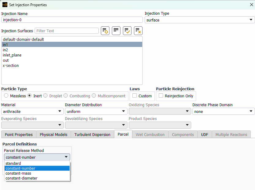

For transient calculations, you can address this by changing the Parcel Release method for the particles from Standard to Constant Number, so that all particle groups start out with the same number of representatives:
This setting has the effect of “padding” the larger size particle injections with extra trajectories so that a constant number of particles can be injected regardless of particle size. (The extra trajectories are weighted lower statistically by spreading the mass of a single particle mass across several trajectories.)

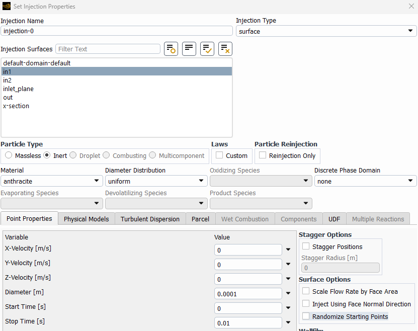

You can further enhance the statistical variations in the injections by randomizing the starting points:

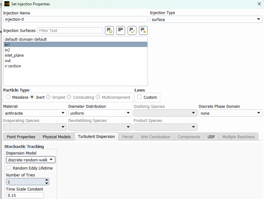

For steady calculations you can activate Turbulent Dispersion. (The Number of Tries acts as a multiplier on the existing number of trajectories/representative particles allowing you to sample more possible particle paths.) This method also has the effect of adding more trajectories and changing the weighting of each one by spreading you the mass of representative particles:
The goal for each test wlll be to gradually increase the number of sample particles (by increasing the number of tries) in each set until the %mass trapped stabilizes. This is how you will know that you have sampled enough trajectories. The number of trajectories required to get an independent solution may be different for each particle size, with lighter particles likely to require more trajectories.
