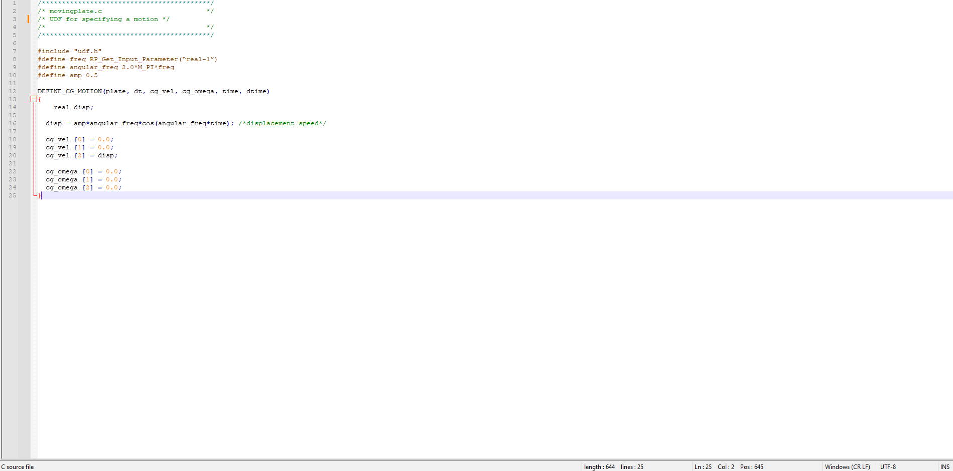

        I have registered the frequency as the input parameter in fluent. My UDF like :
        #include "udf.h"
        /*#define freq 100.0*/
        #define freq RP_Get_Input_Parameter(“real-1”)
        #define angular_freq 2.0*M_PI*freq
        #define amp 0.5
        DEFINE_CG_MOTION(plate, dt, cg_vel, cg_omega, time, dtime)
            real disp;
          disp = amp*angular_freq*cos(angular_freq*time); /*displacement speed*/
          cg_vel [0] = 0.0;
          cg_vel [1] = 0.0;
          cg_vel [2] = disp;
          cg_omega [0] = 0.0;
          cg_omega [1] = 0.0;
          cg_omega [2] = 0.0;

      • LoïcS
        I am only able to attach an image not a file. So i copy paste my code from Notepad++
        #include "udf.h"

    • Amine Ben Hadj Ali
      That content I can compile as mentioned. Please verify that it has UTF-8 format. if it is case then a more in-depth check of your system / machine might be required.

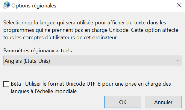

      • LoïcS
        My file is in UTF-8 format as you can see in my screenshot.

          Can you please tell me which setting did help on your side? (That button under Region Settings)?
        • LoïcS
          I didn't touch my region setting
          I just copy my code in a new Notepad++ file and rename it with no space and no underscore.

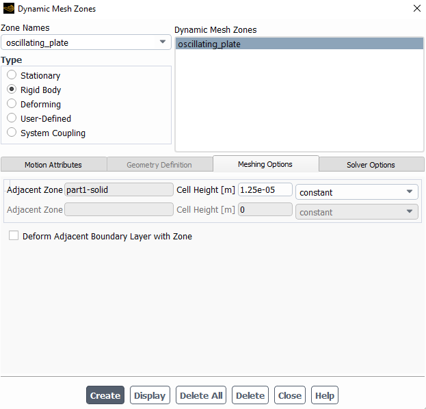

      Please, how can i define the center of gravity and the cell height as input parameters, because it depends of the previous defined distance? I don’t see any option for that.
        I think you cannot define any input paramters directly for these fields but you can derive the required input via Expression and everytime you are asked to give a value (in TUI for example) you let Ansys Fluent return the value of an Expression (Or RP variable etc..).

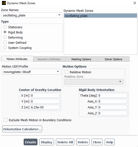

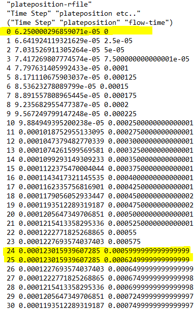

      Hi Dr Amine,
      I'm interested in the position of the plate while using an udf file to put the plate in motion .
      From the collected position of the plate, i noticed that at t=0, the plate is not exactly at the known center of gravity of 6.25e-5 m and the plate has the same position (1.23e-4 m) for 2 consecutive times step (24 & 25).
      How can i correct it please? I want to have the exact known center of gravity (6.25e-5 m) at t=0 and expect different position at time step 24 and 25. Below are the report of the plate position and the udf code. Thanks!
      Bit hard to debug this without looking into the case. You should check what is happening at these two steps with the flow: any strong backflow happening or somethind odd like case not deeply converging within the time step?

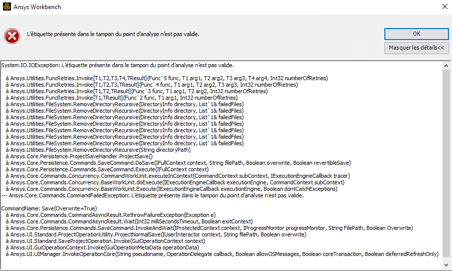

    • LoïcS
      Hi Dr Amine,
      I'm trying to save my files but I've this error message :
      "The label in the test point buffer is not valid"
      How can I fix it, please?
