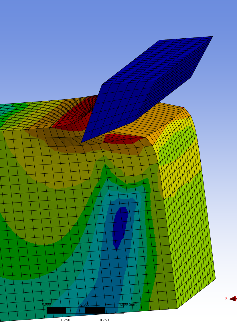

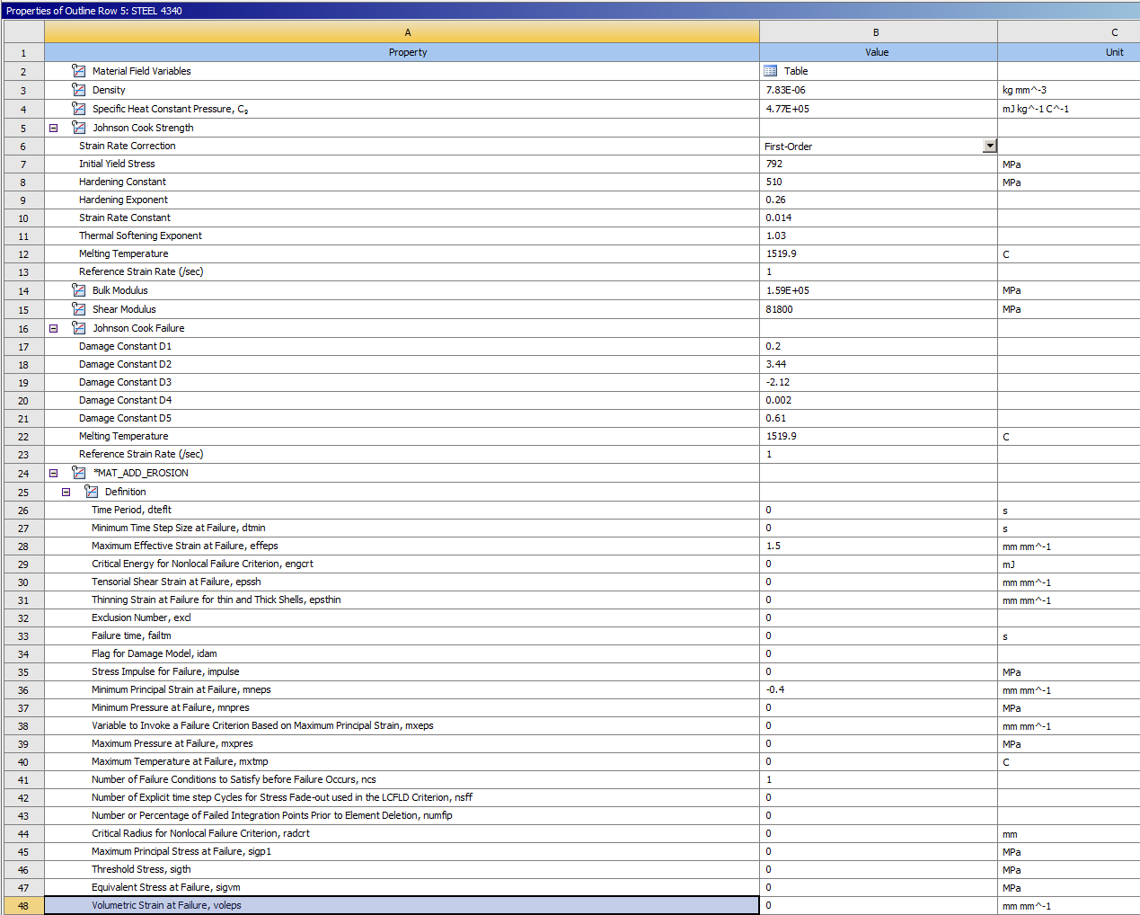

Subscribertrying to perform an FEM metal cutting simulation using Steel 4340 one of the model in explicit materials library. I added Johnson cook failure and also include mat_add_erosion as presented below.Â
The materials will not delete after the rigid tool cut into it.Â
I know its the D1 - D5 that influence the failure, i have tried to adjust them accordingly i did not get the required result. if anyone could guide on this materials i will be glad.Â
I am using this material because its has the nearest properties the materials i am studying.Â
May 26, 2025 at 2:05 pm
Ram Gopisetti
Ansys EmployeeHi,Â
Have you verified whether the model meets the failure criteria of 1.5 plastic strain and a strain of -0.4? Typically, setting the plastic strain with a negative offset, in combination with eroding contact, should be sufficient. Additionally, you may consider refining the mesh on the workpiece for improved accuracy.
Alternatively, exploring particle-based methods such as SPH or SPG could be beneficial, as they offer more robust formulations and enhanced solution accuracy.
Cheers, RamÂ
