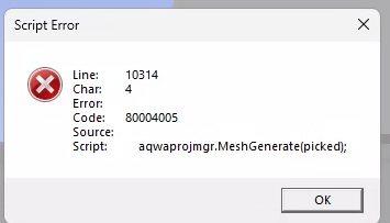

I am trying to simulate a floating body in ansys aqwa and i cannot mesh my geometry while i am facing this mistake "javascipt runtime error aqwa proj mgr.Mesh.Generate(picked);" Can anyone help me?

Ansys EmployeePlease tell us your exact Windows version (winver.exe).

Ansys EmployeeHave you applied the JScriptReplacement registry modification as decribed above?

Gary_S
Ansys EmployeeThe registry key workaround mentioned above (JScriptReplacement) should be the only fix required to resolve the JavaScript 800a000d related runtime errors.
If you are not able to apply the registry workaround due to IT policies, then we recommend reverting to an earlier update of Windows 11.
