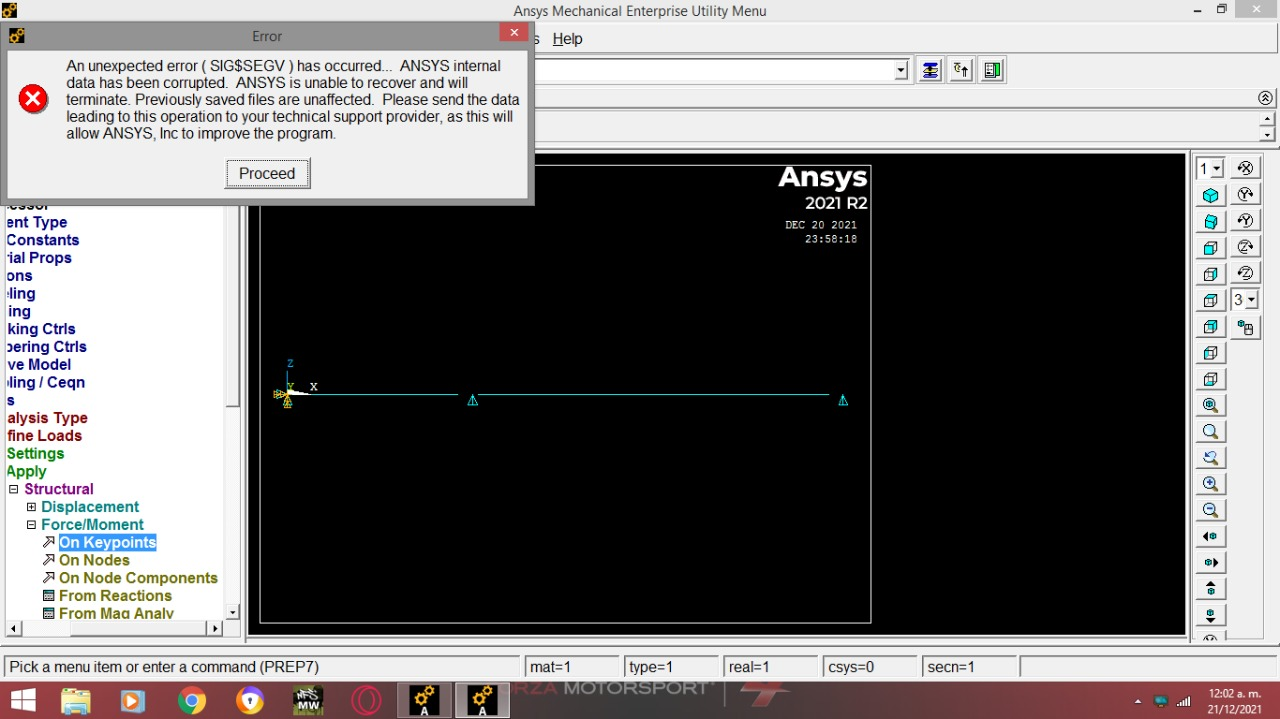

December 23, 2021 at 6:48 pmJessy
SubscriberI already checked them and none helped me at all the error continues to appear
December 23, 2021 at 7:16 pmGeorge Karnos
Ansys EmployeeHi Jessy What Operating System are you running on?
December 23, 2021 at 7:49 pmJessy
SubscriberCurrently on windows 8.1
December 23, 2021 at 7:59 pmGeorge Karnos
Ansys EmployeeThat may be the issue.
2021 R2 is supported on Windows 10.
See Supported Platforms and Operating Systems:
https://www.ansys.com/academic/students/ansys-student
You can look at Windows Event Viewer and see what error is listed. It may give a clue as to what the issue is.
