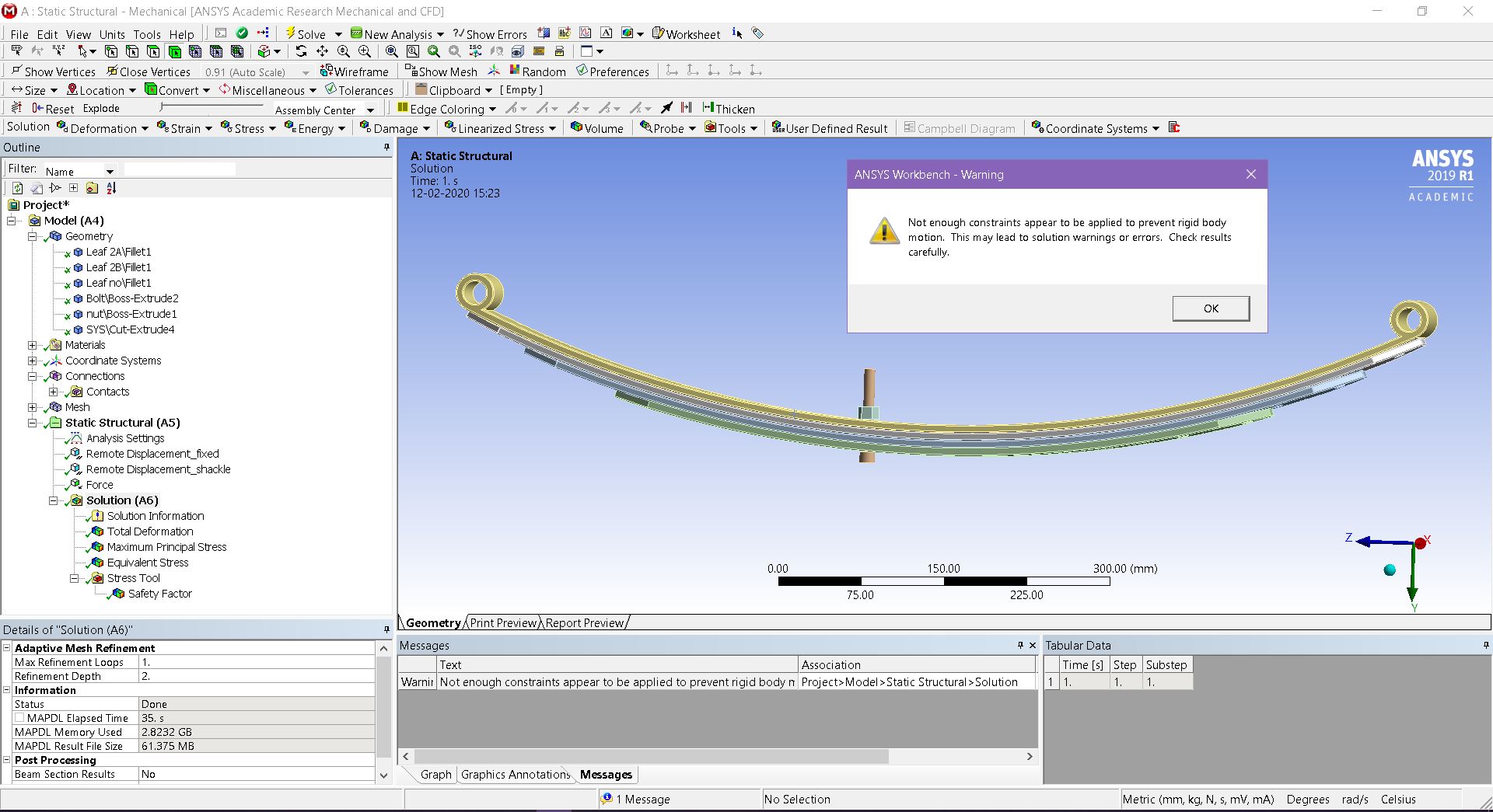

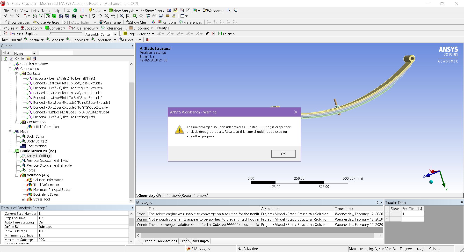

      I am trying to do structural simulation of a multi-leaf spring spring. I used remote displacement with one eye end(fixed end) of the master leaf to have rotation only about X and the other eye end of the master leaf(shackle end) to have rotation about X and translation about Z. I also applied load at the face of the smallest graduated leaf of the leaf spring. ANSYS shows a warning:
      " Not enough constraints appear to be applied to prevent rigid body motion.  This may lead to solution warnings or errors.  Check results carefully."
      ANSYS calculates the values like total deformation (when all the contacts are bonded) but those it values are very unrealistic and incorrect. If i change the contact type to any other type other than bonded it shows solver pivot error. How do I solve this ? Please help
      I see in the image that there is a bolt though the springs. I expect there is one on each side of the center of the leafs and that the spring assembly is symmetric. You can leave the bolt in the model, and actually compress the springs at the bolt using a bolt pretension load as a first step in a two-step analysis, but for your first model, suppress the bolt solids and leave that detail out of the model. You can put it back in later if you want.

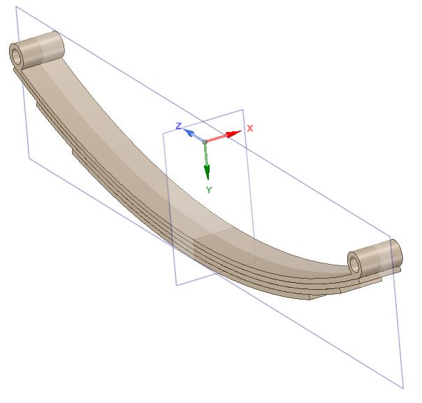

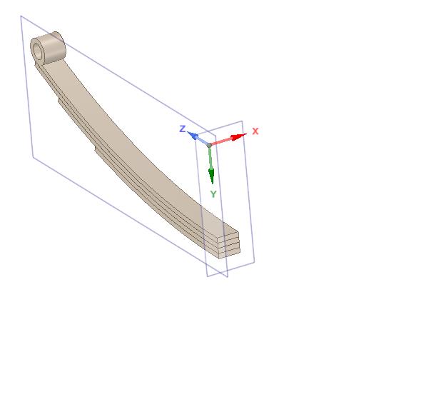

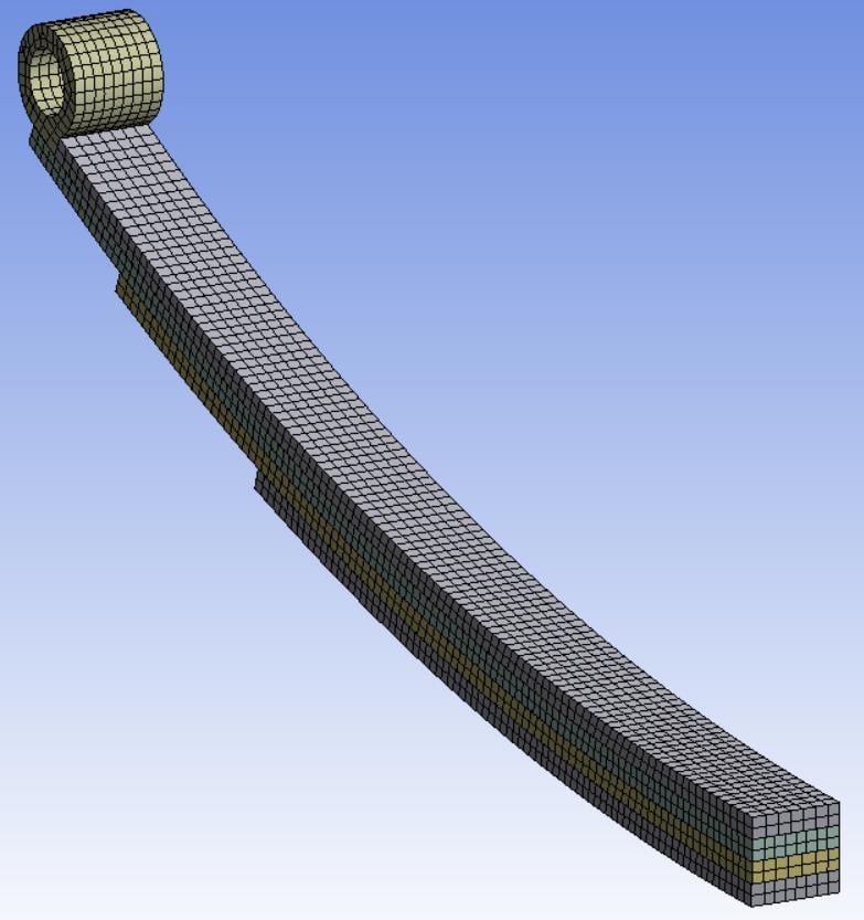

      I recommend you go back to CAD and create two planes, one through the center of the length of the spring, and one through the center of the depth of the spring. If the geometry is in DesignModeler, you can insert a Symmetry object into the model and it will slice the solid bodies in those planes and just bring over a 1/4 model complete with a Symmetry object into Mechanical.
      If you are in a different CAD system, make the cuts and just bring over 1/4 of each body.  Now on every cut face that has a Z-axis normal, create a displacement constraint of Z = 0 and on every cut face that has a Y-axis normal, create a displacement constraint of X = 0.  Those are your Symmetry boundary conditions for solid elements. This means the bodies can only travel in the Y direction, making the job of the solver much easier.
      You had a good arrangement for the ends of the spring, but in the 1/4 symmetry model, the center plane doesn't move along X, so the end of the spring needs that freedom. That means the one remote displacement is like you had on one end, all fixed at 0 by Free in Z displacement.
      In meshing, make sure you have at least two elements through the thickness of each leaf.
      Choose the cut face of the smallest leaf to apply the load to. I recommend you choose a remote displacement, and you only need to specify a Y displacement.  Insert a Force Reaction Probe into the Solution branch and select that remote displacement to see the force vs. deflection curve. Displacement inputs make the job of solving easier than Force inputs.  Because you have only 1/4 of the material, it will only be generating 1/4 of the force at each increment of displacement, so multiply the Force Reaction by 4 to get the force that the full model would have delivered.

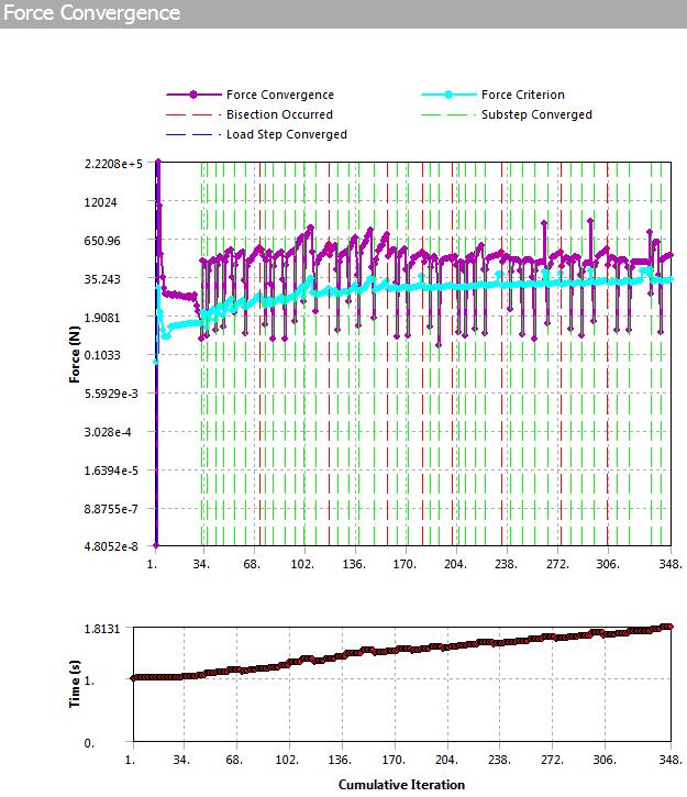

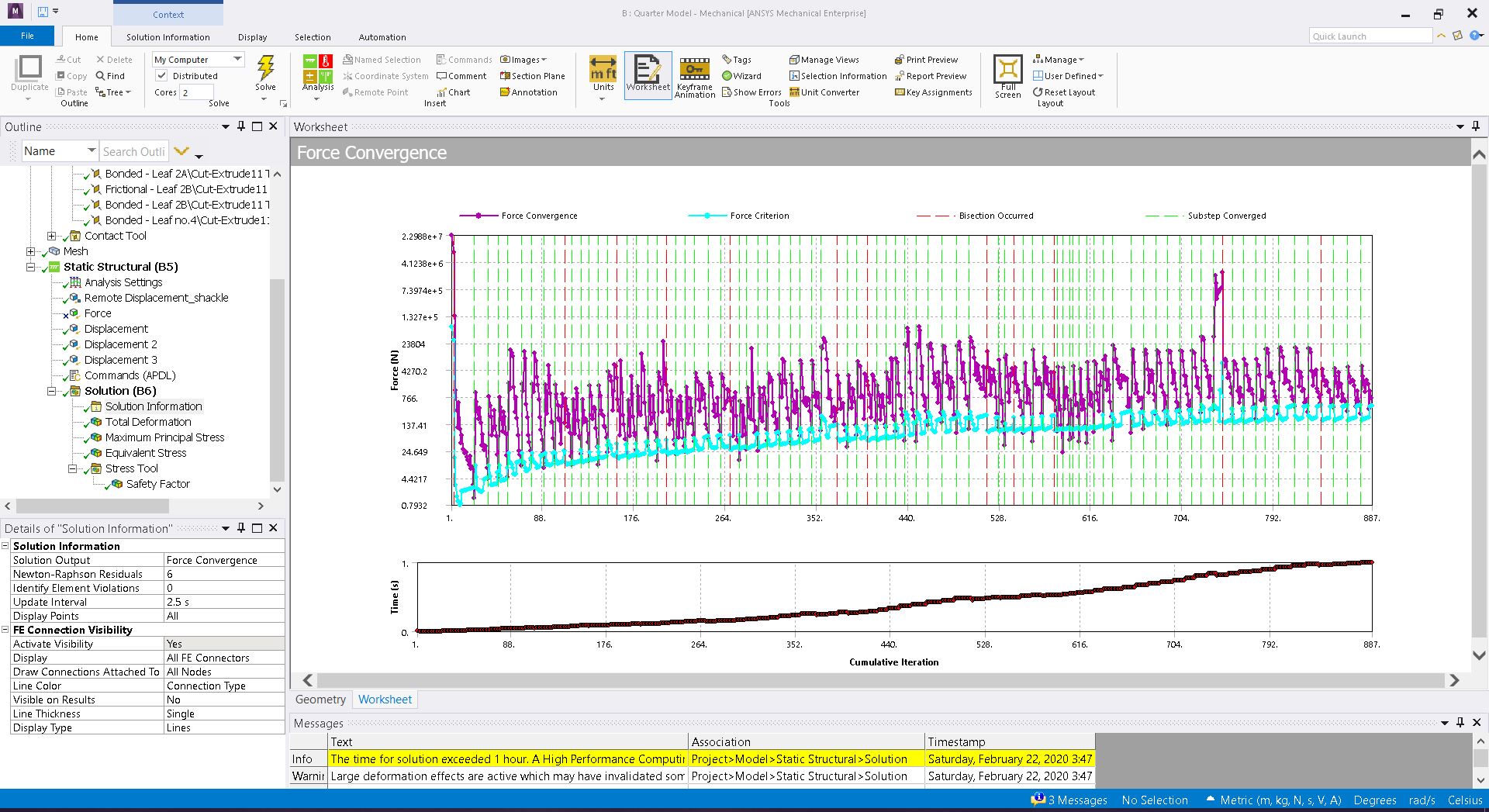

      While the solver is working, look at the Newton-Raphson Force Residual plot under the Solution Information folder.

      Sir, the leaf spring will only be symmetrical about the plane passing through the center of the spring (left side symmetrical to right side). The model of the leaf spring is based on the rear leaf spring of Tata Ace minitruck and the bolt-nut are a little offset from the center of the spring. What should be the preload value for bolt pretension? And also how much should we put as the value of coefficient of friction if we have frictional contact between the leaves.

      Sir, from the photo i have given before, the contact table shows some penetration. Sholudnt the penetration be zero, as the leaves should slide with respect to each other?
      I only see two Frictional contacts, but it looks like there are four layers to the assembly, so there should be three Frictional contacts. Use a value of 0.2 for the coefficient of friction. You can run the model two more times and see the effect of setting the friction to 0 and to 0.4 to learn the sensitivity of the force to the coefficient of friction.
      What is the size of the bolt going through the leafs?  Use Bonded Contact of the bolt head to one face, bonded contact of the nut flat to the opposite face.  You must go into CAD and split the cylindrical face of the bolt shaft at the plane of the nut. Then you use bonded contact of the shaft face to the nut face.  The other part of the shaft cylindrical face gets the Bolt Pretension load.  Try 10,000 N as a start value.  This has to be applied in step 1, then the bolt pretension is set to Lock in step 2.  Step 2 is when the force or displacement is applied to the center of the assembly.
    • Samyak97
      Ok Sir, I added the third frictional conatct. What about the penetration?How to resolve that?

      i am facing these errors.
      Please create a workbench project archive .wbpz file and attach it to your post above.
      There are many posts for Unable to Converge.  You can read a few while you are waiting for me to look at this model.

      If you delete the edge blends on the solid bodies before you bring them into Mechanical, you will get a more efficient mesh filling these leaf springs.
      Without touching the geometry, just by setting the Mesh Defeaturing size appropriately, I can eliminate the blended edge.
      The bolt does not stand up straight like this, it should be aligned with the surfaces it is clamping.
      I recommend you delete the bolt and nut and the four holes in the leafs, delete the edge blends, and make the 1/4 symmetry model produce some useful results.
      Then you can go back and make a more sophisticated model.

      Sir, how is 1/4 th model possible here?
       I am getting this error.
      also the errors which are consistent:
      "Not enough constraints appear to be applied to prevent rigid body motion.  This may lead to solution warnings or errors.  Check results carefully."
      "The unconverged solution (identified as Substep 999999) is output for analysis debug purposes. Results at this time should not be used for any other purpose."
       Even after setting geometric modification as Adjust to touch the solver pivot error is coming.
      Full model and Quarter Model.

      I have also done the simulation with quarter model. I am attaching that also below. I am not getting any errors in the quarter model but the values of deformation do not seem to be reasonable at all. Please check.
      You don't have two elements through the thickness.

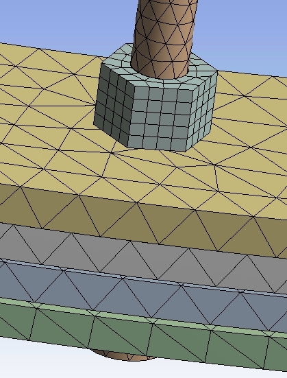

      You have both Bonded Contact of the Bolt shaft to each hole, and you have Bolt Pretension, which can't work properly with the Bonded Contact. I suggest you delete Bolt Pretension.  If you do that, you don't need a 2 step solution and you don't need the nut.
      If you decide to delete the Bonded Contact of the Bolt Shaft to each hole, then Under Analysis Settings, for Step 2, Auto Time Stepping should be On and the Initial Substeps set to 100. but if you delete the Bolt Pretension and have only Step 1, then use the same settings there.
      You put 6 NR Residual plots under the Solution Information folder, did you look at them?  With one element you can see where the problem is. Remesh with 2 elements through the thickness. Set the Mesh to use Quadratic elements since you have long curved faces, you don't want flat facets on linear elements. It would be better if you can make fewer elements along the length and width while maintaining the 2 elements through the thickness. That way there are fewer nodes in the contact definition that have to resolve contact.

      If it didn't converge with 50 (or 100) iterations, I would look at the NR Residual Force Plot and improve the element shape or reduce the element size in that area.
      With two elements through the thickness, it will take a lot longer to solve, but if you cut it down to a 1/4 model as I suggested, it would solve 10 times faster.
      If you convert this to a 2D plane stress model, it would solve 100 times faster.

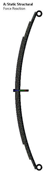

      I left it running and it had no problem, but I Interrupted the solution so I could plot some data. Here is the Force vs Displacement.
      The spring rate is 99.5 N/mm.
      Here is the starting shape and the point I stopped it at.
      In my version, I kept the Bonded Contact to the bolt and suppressed the Bolt Preload.
      The 348 iterations took 5 hours and 40 minutes on 12 cores.  Attached is an ANSYS 2019 R3 archive.

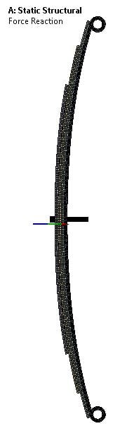

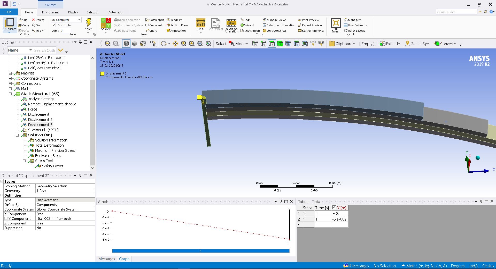

      I replaced your force with a 50 mm displacement at the center.
      I changed your Fixed Support on five faces at the center to a Displacement  Z = 0
      I added a Displacement X = 0 to the five faces on the YZ plane.
      I set the Initial Substeps to 100.
      It did 709 iterations in 1 hour 50 min on 12 cores that was almost to 50 mm when I stopped it.
      After I multiplied the Reaction Force by 4 to go from the quarter model to the full model, the spring rate was again 99.5 N/mm.

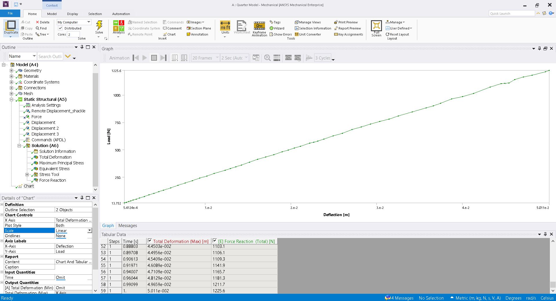

      Can you please tell me how did you plot the Load vs Deflection /Force vs Displacement graph. Is the simulation not possible by using force instead of displacement? Please share your file. I will view it in a student version of R3 on another computer.

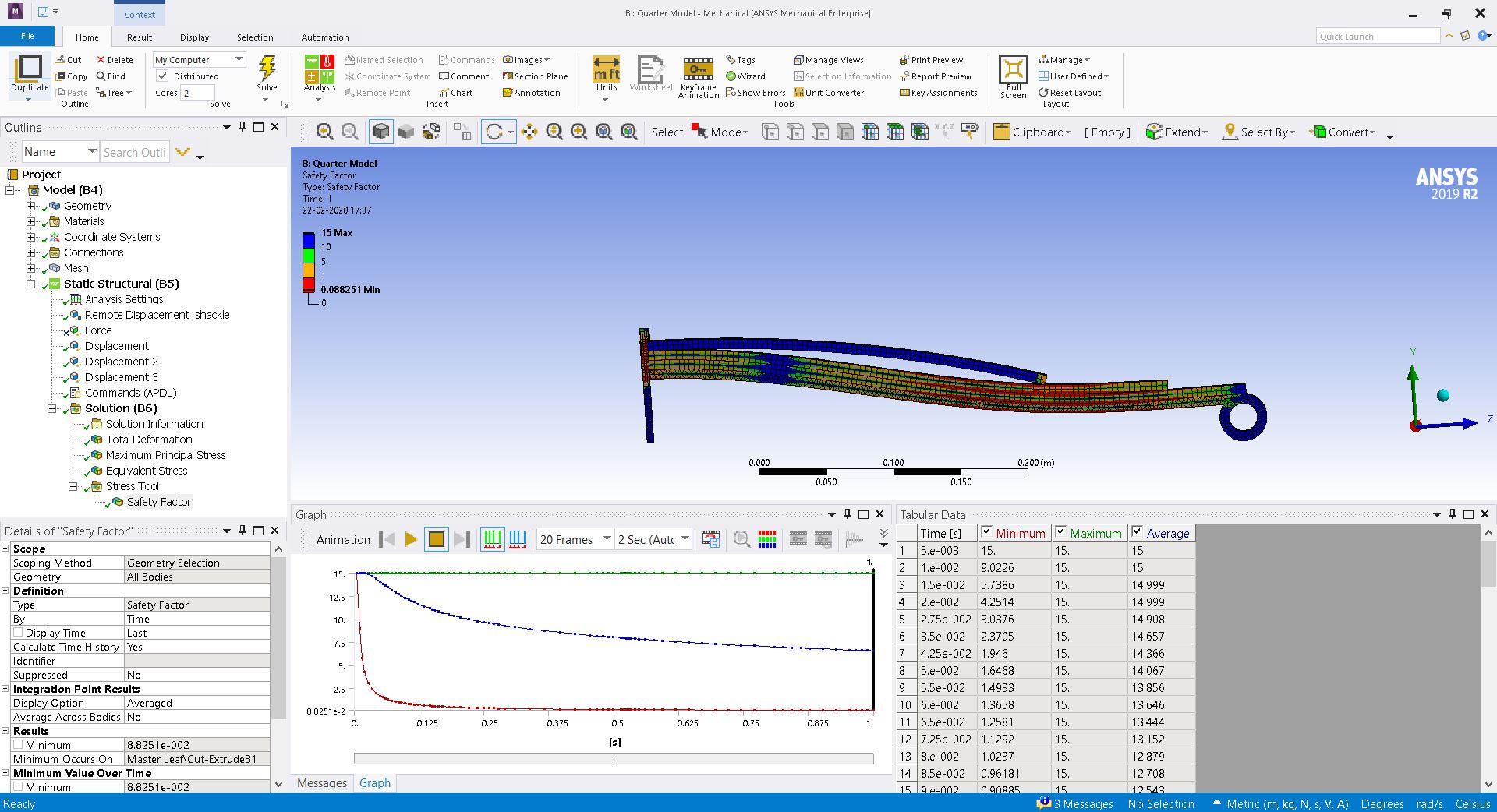

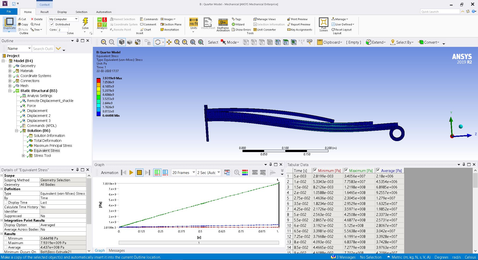

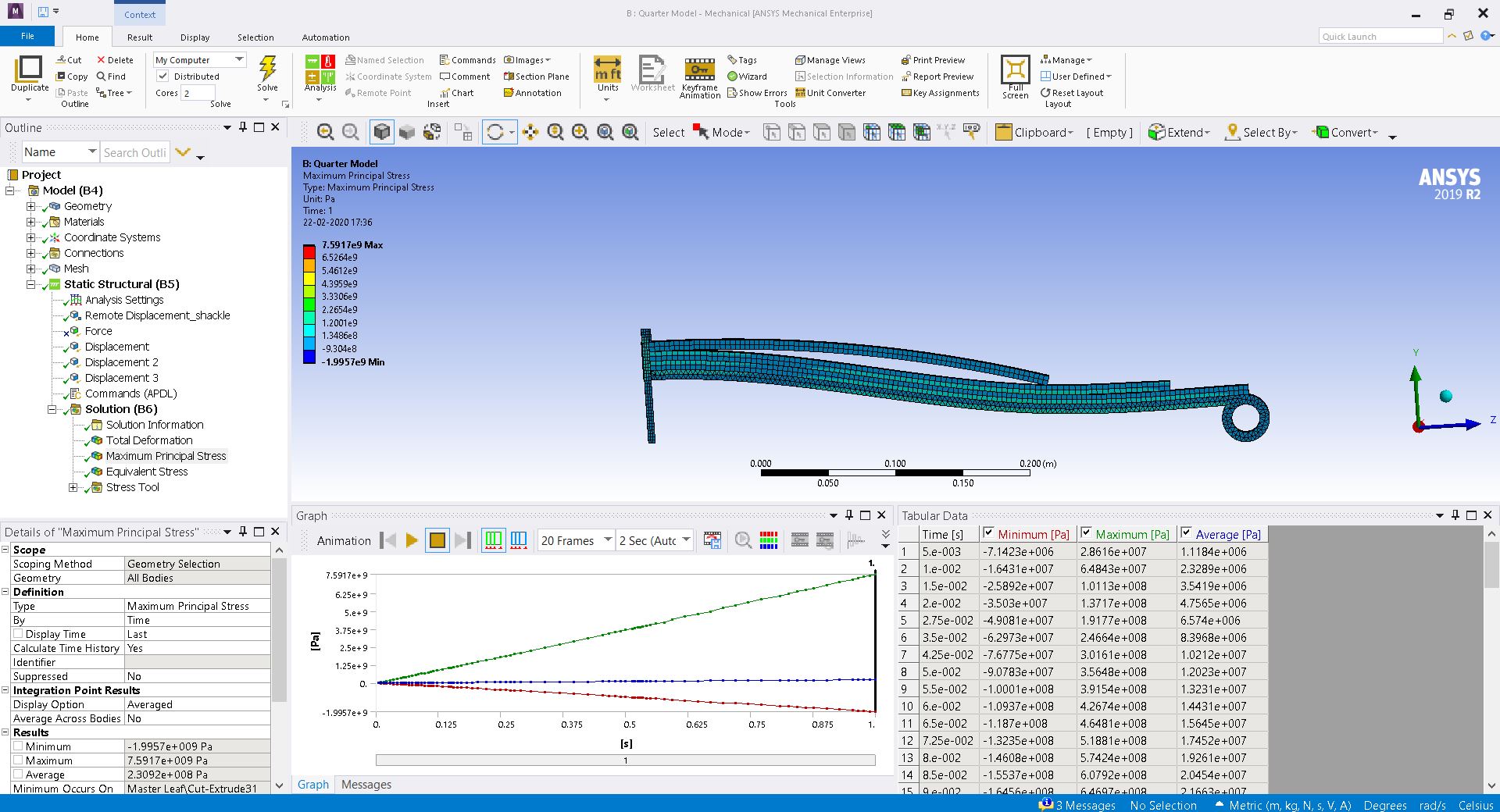

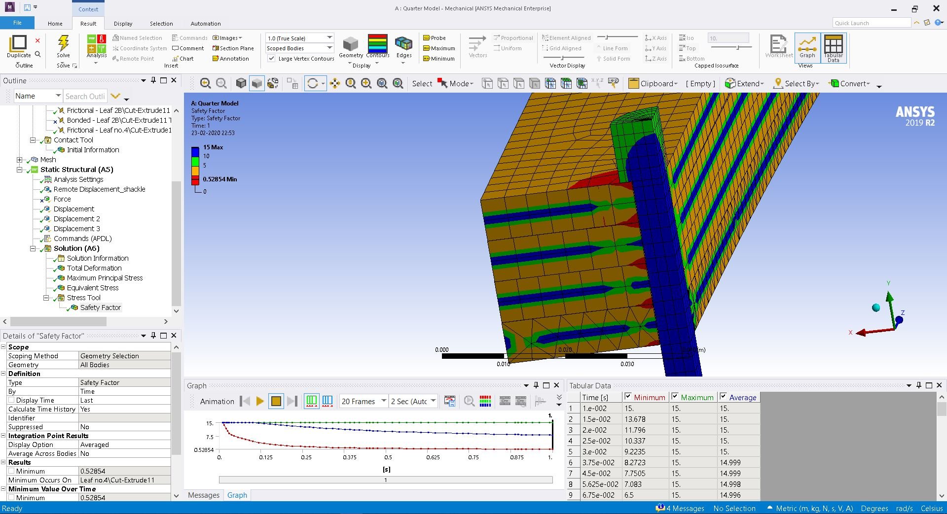

      Total Deformation:
      FOS:
      Force Convergence:
      Equivalent Stress Von-Mises:
      Max, Principle Stress:

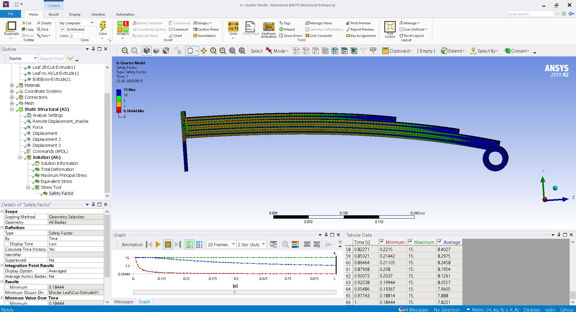

      I tried the simulation again and this time, I put the 50mm displacement on the top face of the bolt instead of the face of smallest leaf.
      So, this time i got:
      Still the minimum FOS is 0.18. The min. FOS should be 1 or something more than that. How do i get the proper FOS here?
      Please Help.
       Is 50 mm displacement too much for the quarter model?
      Where is the minimum FOS?  Please turn on the Minimum flag on the results, then zoom in to that location.
      If the minimum is at the bolt or bolt holes:
      • Turn off Bonded contact of the bolt shaft to the holes. That is not needed.
      • Change the Bonded contact of the bolt head to the small leaf to Frictional contact.
      If the minimum is elsewhere, insert the image of that.
    • Samyak97
      Yes, the min was at the bolt or bolt holes. I suppressed  Bonded contact of the bolt shaft to the holes and changed the Bonded contact of the bolt head to the small leaf to Frictional contact. Still the min. FOS is 0.52 which is less.
      You can ignore the localized high stress under the bolt head because you caused it when you greatly simplified the real load path and artificially increased the stress by concentrating all the load through a small area. One way to more easily do the ignoring is to create a plane a short distance off the center plane. Slice all the spring leafs and use Shared Topology to reconnect them. Now when you do the Safety Factor plot, don't use all bodies, use the long end of the leafs and don't pick the bolt or the short piece around the bolt hole.
      Another way to get rid of the localized high stress is to delete the Displacement BC on the bolt head and put the Force on the underside of the short leaf.  You can even slice the short leaf and create a short section near the center to apply the force over a much larger area than the bolt head.
      If you don't want to ignore the localized high stress, then you must represent in a more realistic way that load path from an axle to the spring.

      Ok sir. I wanted to ask about a mistake i made. For the quarter model, in the spaceclaim, i made two new planes and used the option of Split by plane in the Prepare section. Is there any way i can add the symmetry option (i did not find symmetry option in Spaceclaim, later found that its in DM) now in order to realize the full model results?
      Another doubt: If we try to realize the full model from the quarter model, how will it produce the result in the full model as the conditions are not the same on both the sides of the spring: one eye fixed and one eye with shackle. As the quarter model has shackle condition on the eye, wouldnt it consider the condition at the other eye as shackle(when full model is generated) instead of fixed?
      SpaceClaim doesn't automate the addition of Symmetry BCs after a Split by plane.  That is why I changed your Fixed Support on five faces at the center to a Displacement  Z = 0 and I added a Displacement X = 0 to the five faces on the YZ plane.  Those are the symmetry BCs.

    • Samyak97
      Sir, I plotted force reaction(Total) vs Total deformation(Max).
      Is there any way so that the graph starts from the origin?
      Copy the tabular data and paste into Excel. Add a row and put 0, 0 in the first row. Plot the data in Excel.

      But, when i try convert the simulation graph of load vs deflection of quarter model(which comes out to be linear) to full model by multiplying force by 4, the graph is no longer a straight line so it does not coincide with the experimental graph anymore.
      Please help. Thank you for your time.
      Best Regards,
      Samyak
      The displacement calculated in the 1/4 model is correct.  Only the Force is multiplied by a factor of 4 because there is 4 times more material in the full model.  If all that material was deflected to the exact same displacement (mirrored through the two planes) it would take 4 times more force.
      The force-deflection curve on the 1/4 model is nearly linear.  When you multiply all the force values by a factor of 4, it is remains nearly linear, just the slope is now 4 times steeper.
      Please reply with a graph showing the experimentally measured load vs deflection and the overlaid 4X simulation force.
    • Samyak97
      Hello Sir,
      Its ok. I solved the problem on my own. I made some mistake during plotting.
      Is there a specific option to calculate the spring stiffness/ spring rate in ANSYS?
      No, you must plot the data in Excel and fit a linear trend line to get the spring rate.
