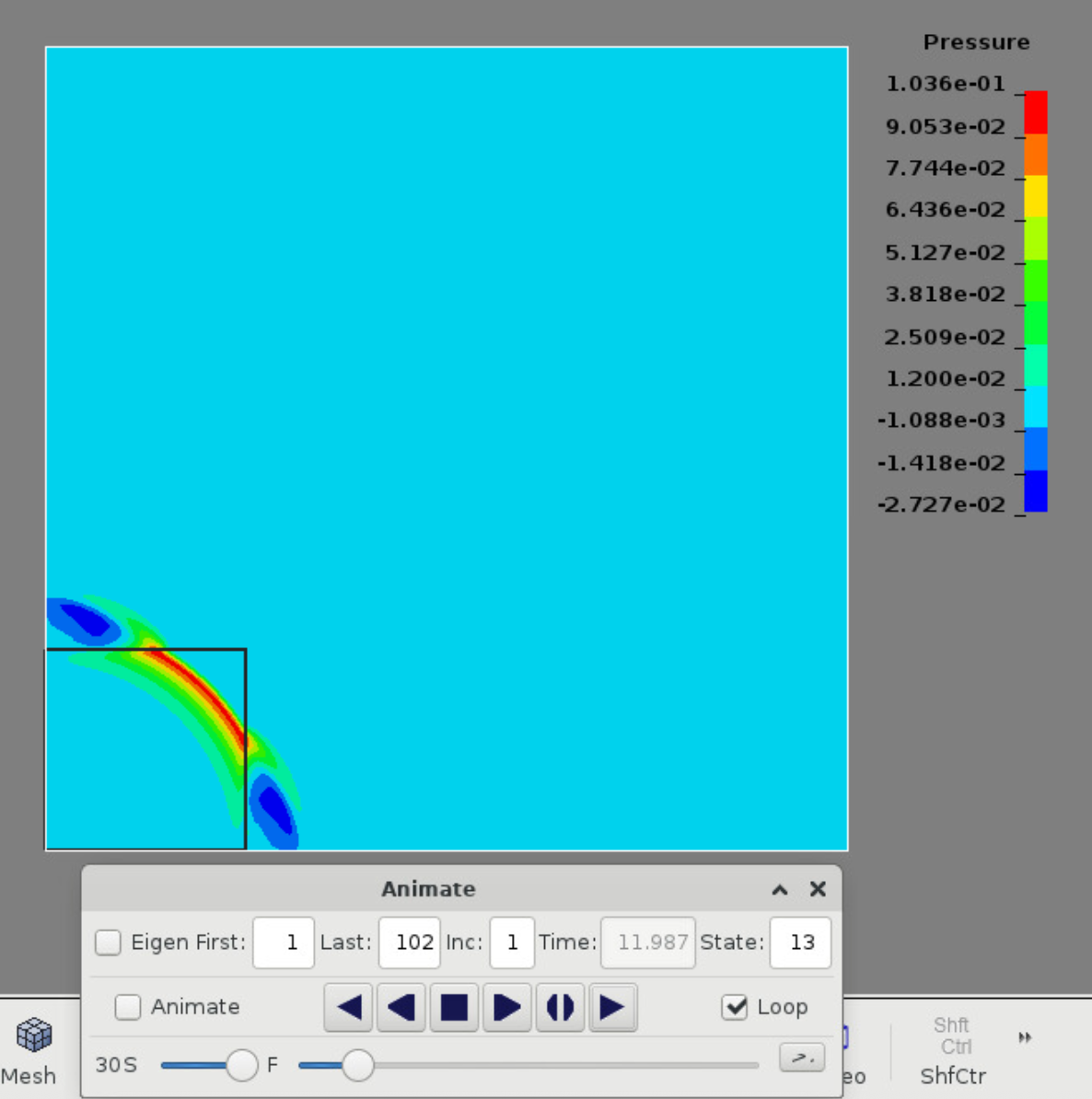

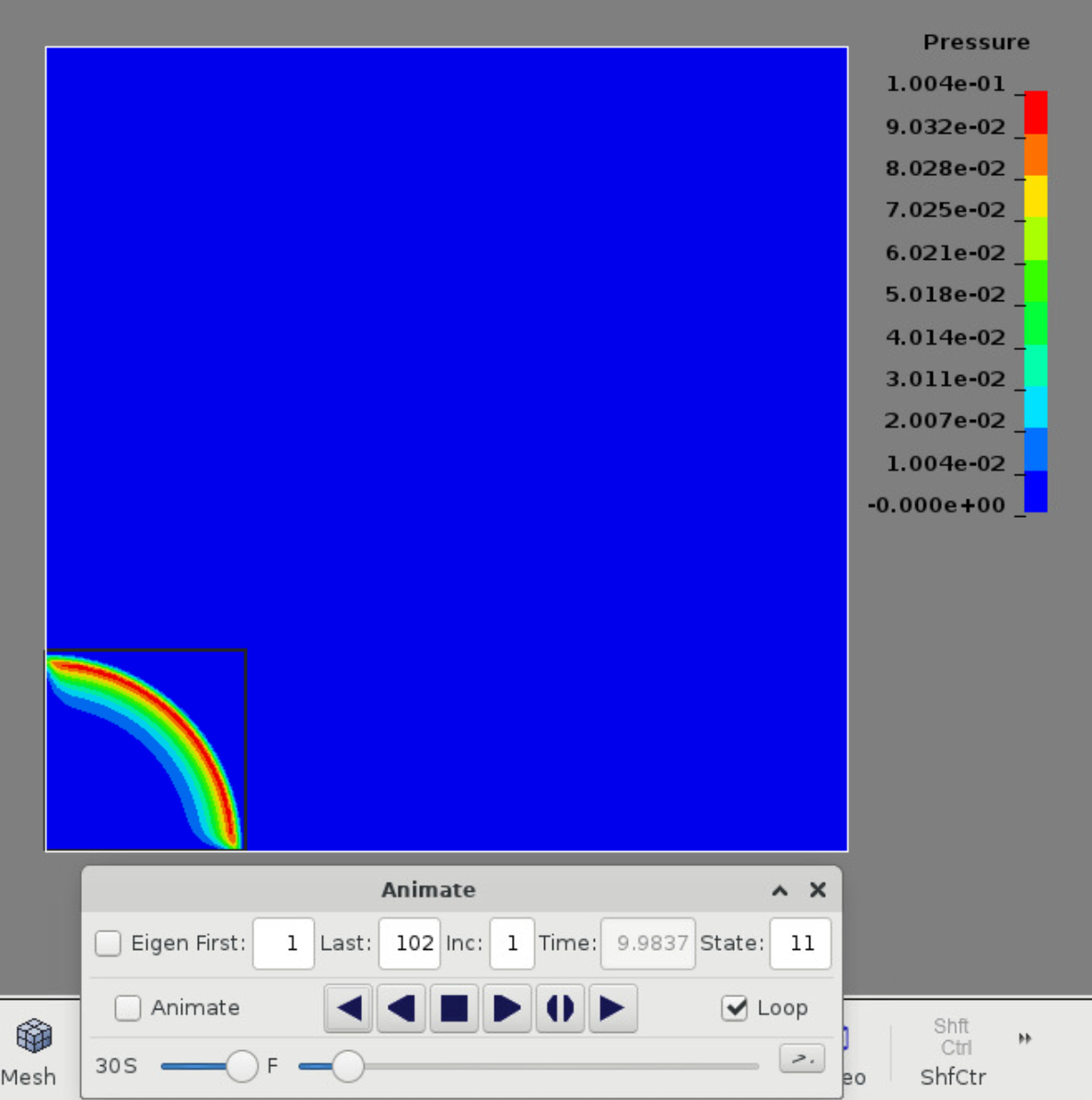

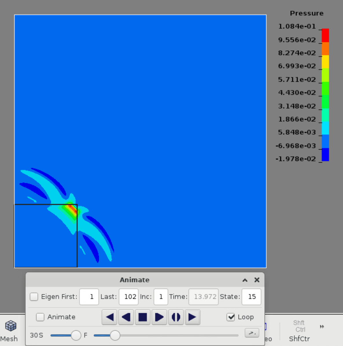

      Hello, I would greatly appreciate some help regarding my code. I am taking an official LS-DYNA example, Underwater F (https://lsdyna.ansys.com/underwater-f/), and modifying it to create an S-ALE mesh without the cutout.
      I am generating a square field. I fill the entire region with water and there is a smaller square region in the bottom left corner, in which I place an explosive material. I detonate the bottom left corner, the origin, at time 0.
      However, the detonation front created by this explosion is not propagating smoothly into the water. It looks like there is a boundary at the box region, even though I have not defined a boundary. Might this be due to a discontinuity in the interface between the two materials or is there something I am missing in my code? How would I fix this? Thank you very much in advance.

      Here are screenshots of the relevant time steps:
