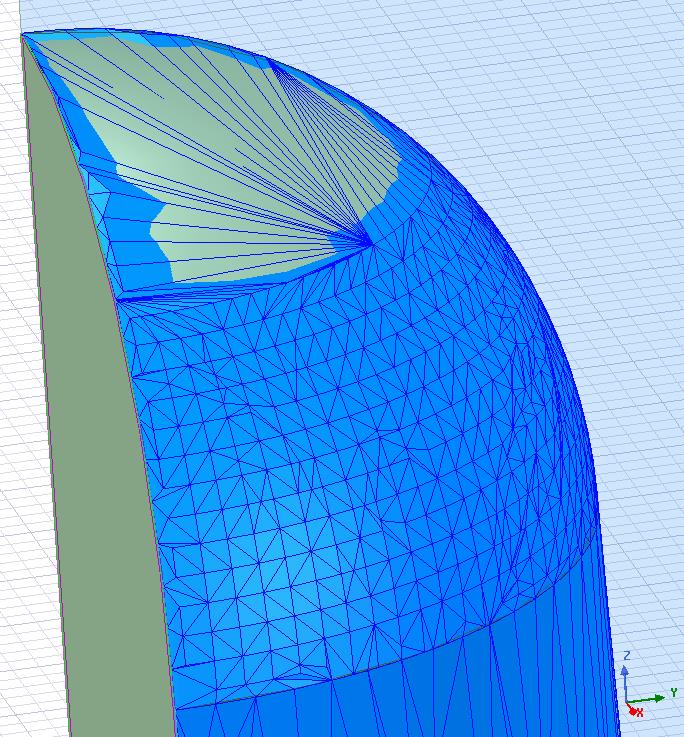

      As part of my Master's Thesis, I am using ANSYS Maxwell to run a series of simulations of an array of micro "needles" to see how the electric field changes as the ceter-to-center spacing changes. The needles are a cone with a hemispherical tip, modeled using Maxwell 3D in ANSYS Electronics Desktop 2017 as 1/4 of the full array with symmetry boundaries applied. Below is a screenshot of the model at 20um spacing:
      Needle 20um Spacing
      The issue I run into is the meshes of the needle tips along the symmetry boundaries do not generate properly when I get to a spacing of 20 um. I have tried using different mesh operations to better refine the mesh, but I still run into some sort of "hole" in the mesh. I have also searched through Maxwell3D's documentation and online, but have not found any solution. Additionally, no one at my school has any prior experience with the particular software package as we just recently got a license for it. Here is an image of the corner needle's mesh at 20um spacing with a 0.01um length-based mesh operation on the tip:
      Corner Needle 20um Spacing
      As you can see, the mesh near the bottom of the spherical region starts out fairly uniform, but once it gets close to the tip, it falls apart. The needles along the boundary sides also have a similar issue, while the 4 "internal" needles that are fully modeled have no issues with mesh generation. I am not very experienced with mesh generation and simulations, so I am not sure if the mesh is too fine, too coarse, or if there is some setting or function I need to apply in order to resolve the issue. If anyone with Maxwell3D experience has any suggestions, that would be greatly appreciated as I need results in order to finish my thesis.

      Thanks for taking a look. I posted the same question on another forum, and someone mentioned to adjust the surface deviation and aspect ratios in the initial mesh settings. I did that and it seems to have fixed the issue, as I no longer get the type of breakdown seen in the pictures from my original post. The results so far look promising, so hopefully no other issues come up.
