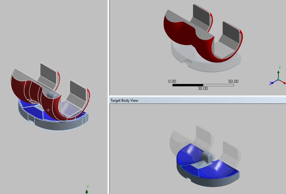

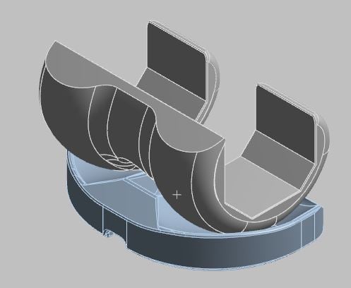

I'm trying to simulate a knee replacement assembly, shown below.

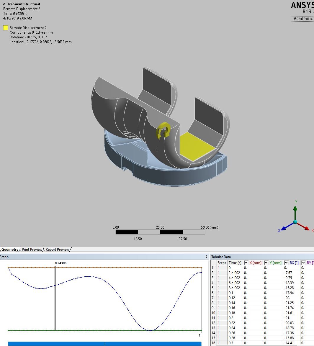

I want the knee to have some sort of kinematics,so I've set up a remote displacement on my femoral component, and have everything fixed except the translation in the z-direction (free), and rotation in the x-direction (input gait data). I've also placed a remote displacement on the bottom part, and fix it in all but one-direction (it can move up and down). I've put a force on the bottom of this, and have it set to push up (to simulate the force of someone walking).
I've instituted a frictional contact between the articulating surfaces.

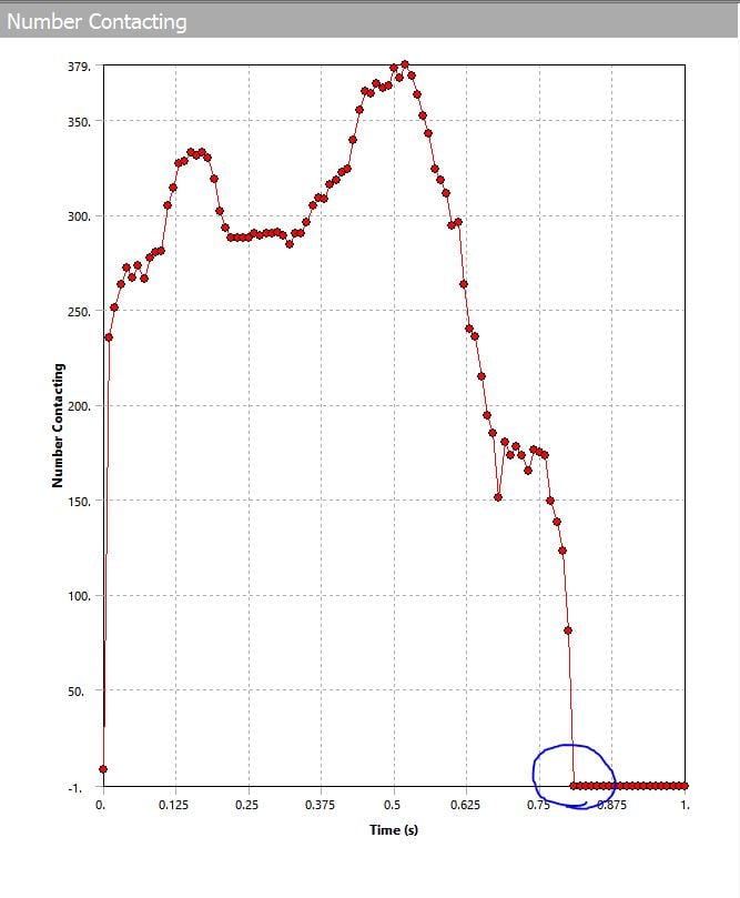

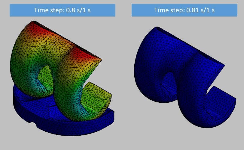

Everything tends to run fine, I get articulation like I'm expecting, and then, all of a sudden, the contact points seem to disappear.
Physically, it's acting as if the assembly sees itself within one time step, and then it doesn't the next.
