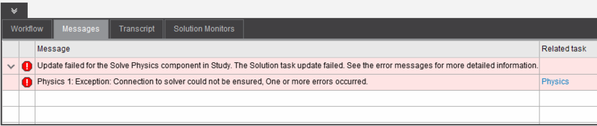

      Getting an unfortunate issue with AIM's solver unable to connect after installing the latest Windows 10 Insider 19H1 Build (18346.19h1_release.190222-1556):
      It is not the model, this ran before on the same machine and still runs on another one...  Any recommendations on how to debug this?

      It's unfortunately across the board...  I really think it's caused by the latest Windows 10 Insider build as this is the only thing that changed since the AIM solver connection stopped working...  That being said, I'll send something over, maybe I'm doing something wrong...
    • tentechllc
      I can confirm there is something happening between AIM solver and Windows Insider builds.  As an experiment, I have just installed build 18845.rs_prerelease.190223-1718 of Windows 10 on another machine and tried to solve a model that was solving perfectly right before installing this prerelease Windows 10 build.  Sure enough, I'm getting the same error mentioned above.

      Some members of our team too faced the same issues. Launching Discovery AIM with 'Run as administrator' solved the problem in some cases. Can you please try the same?

        Subashni Darn, you got my hopes up    Unfortunately, this didn't work on the computer with 18845.rs_prerelease.190223-1718

      I can confirm that AIM solver works with latest Insider Build, 18351.19h1_release.190301-1611 installed today.
