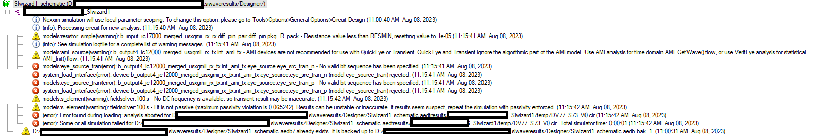

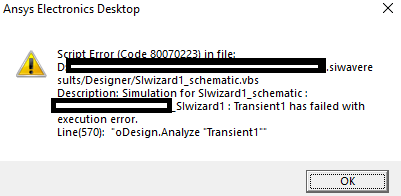

2) After SIwizard is done with S-parameters computing, I am getting the following error on AEDT:
This error makes me unable to get any result. Could you please tell me how to fix that error?

Ansys EmployeeFor the second item, that is a non-specific error that just tells us that the Circuit part of the project did not run to completion. To debug that further you will have to open the AEDT project that was created by the SIwizard and look at what messages were generated for the transient solve on that side. If you can post more info from that part here, I will hopefully be able to provide more specific details.Â

Ansys EmployeeHello Alexandre ,
That errors state that there are two eye source components on your schematic that don't have bit patterns set. Click on the proprities for those components, select hte "Bits" tab and the click on the box next to the "Bit Pattern" property to bring up the form to specify the bit patter for those sources. If you provide a valid setting in that form, it should get you past that error. Please let me know how it goes.Â
