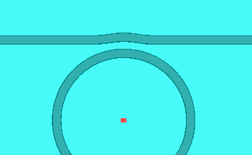

I'm trying to generate smooth bends using the waveguide structure. However it seems to be extremely inconsistant.
I have a Lumerical script to generate a ring resonator, and a waveguide coupler. It seems capable of reliably generating the requested structure, but appears to break down for large rings and reverts to making straight waveguides.
And a 100 um "ring".
Any idea why larger rings might be problem?
May 22, 2025 at 2:39 pm
Edward Krock
SubscriberIf it helps, the code is copy pasted below.

Forum ModeratorDear Edward,
I’ve checked your script, and it works fine on my end. Thank you for sharing it, this really helps speed up the process.
You can control rendering accuracy by right-clicking the object > Edit object > Graphical rendering tab > adjusting the detail slider. However, this setting should not affect the view that much.
While the rendered geometry may appear misleading, you can get a more accurate view of the structure using a Refractive index monitor. You can even use the preview option before running the simulation. Hopefully, the actual structure is unaffected.
I ran my tests using 2025 R1.3 on Windows. If you’re using an older version, I recommend upgrading and testing again.Best regards,

SubscriberHi Kirill,
It seemed that for my 2023 version the problem is more than graphical, the refractive index monitor also shows this issue, but you were right! It was the version, I have been stubornly sticking to a 2023 version, updating fixed it!Â
