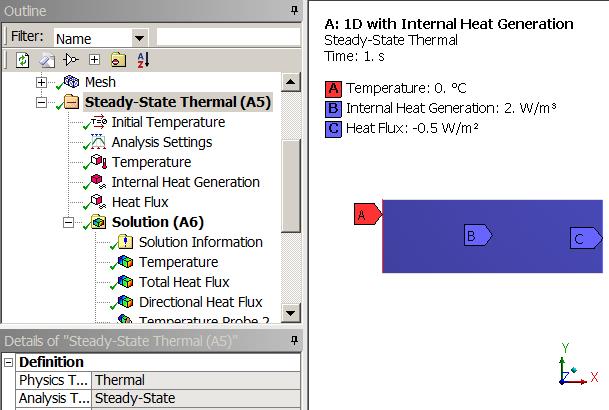

      If you are referring to where my image says: A: 1D with Internal Heat Generation, that is because I renamed the system block from Steady State Thermal on the Project page of Workbench.  That can be useful when you have several blocks on the page since the label shows up in the plots!
      I don't see any images in your reply. You have to save to a file before you can add them to your post. You can grab and paste from the clipboard.  Is your model giving the correct temperature now?

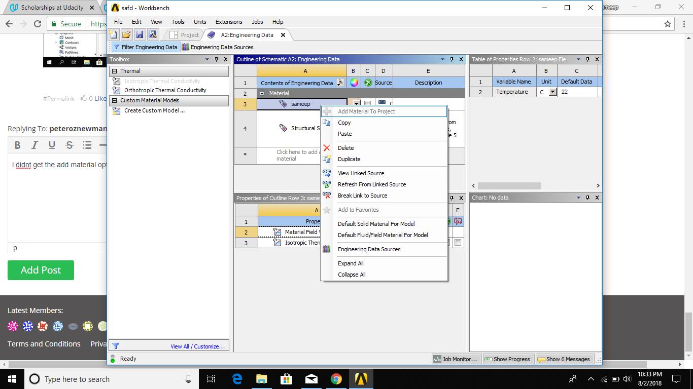

      i didnt get the add material option

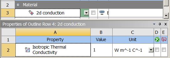

      In your post two above, I see you have a material called sameep that has the thermal conductivity property, but the drop down menu is covering up the value assigned and the units.
      I ask again, is your model now giving the correct temperature result?

      You didn't show a screen snapshot of your model with the boundary conditions, the way I showed in my screen snapshot.

      Please be more precise about your questions? Are you now asking about Fluent or still regarding ANSYS with the edx workshop? If yes show the screenshot of your model with all boundary conditions as highlighted by peteroznewman
