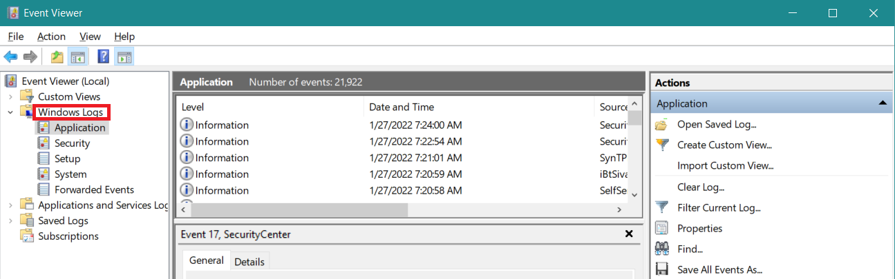

SubscriberI have downloaded ANSYS 20221R1, and I receive the following error message:
"The application failed to initialize. This may be caused by an issue with the installation."
I have tried uninstalling, removing all folders/files in the Program Files/ANSYS Inc directory, and reinstalling. No luck. I also see no install error logs in the program files directory. Any indications on how I can determine the issue, and resolve?
January 27, 2022 at 12:46 pmGeorge Karnos
Ansys EmployeeAfter trying to start the program, can you check the Windows Event Viewer
(in the search field on the task bar type in: Event Viewer)
Once it appears, click on Windows Logs and then check the Application, setup, and System logs
If you find any errors related to the program, please double-click on it and post a screenshot as we are not permitted to open files.

SubscriberThe screenshots aren't coming through for some reason. Here are copies of the error details:
Error1:
Application: Discovery.exe
Framework Version: v4.0.30319
Description: The process was terminated due to an unhandled exception.
Exception Info: System.NullReferenceException
at Apollo.Engine.Graphics.Tools.SurfaceAnimationToolWrapper+PInvoke.DestroyInstance(Apollo.Engine.Graphics.ApolloGraphics, Apollo.Engine.Graphics.Tools.SurfaceAnimationToolWrapper)
at Apollo.Engine.Graphics.Tools.SurfaceAnimationToolWrapper.Dispose(Boolean)
at Apollo.Engine.Graphics.Tools.SurfaceAnimationToolWrapper.Finalize Log Name: Application
Source: .NET Runtime
Event ID: 1026
Level: Error
Error 2:
Faulting application name: Discovery.exe, version: 22.1.0.0, time stamp: 0x61a3bbd4
Faulting module name: unknown, version: 0.0.0.0, time stamp: 0x00000000
Exception code: 0xc0000005
Fault offset: 0x00007ffad156f390
Faulting process ID: 0x850
Faulting application start time: 0x01d81389bc9ec93b
Faulting application path: C:\Program Files\ANSYS Inc\ANSYS Student\v221\Discovery\Discovery.exe
Faulting module path: unknown
Report ID: 3a2c89dc-d399-454a-8c43-8c7709e33086
Faulting package full name:
Faulting package-relative application ID:
Source: Application Error
Event ID: 1000
Level: Error
Let me know if more info is needed. Thanks.
January 27, 2022 at 3:06 pmGeorge Karnos
Ansys EmployeeCheck the Graphics Card driver. Verify that it is the latest.
The following is a search of the forum for the exception code 0xc0000005 /forum/search?Search=0xc0000005 There are some other posts to look at...

SubscriberRecently had a customer run into this error. The fix for them was as follows: Please try installing the VC_redist.x64.exe and vc_redist.x86.exe for Visual Studio 2015, 2017, 2019 and 2022 package. If they already have 2015 installed, you may need to uninstall before installing this downloaded version. https://docs.microsoft.com/en-us/cpp/windows/latest-supported-vc-redist?view=msvc-170
