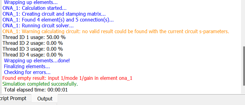

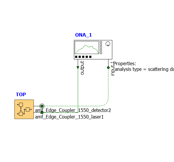

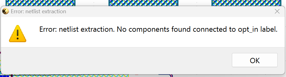

SubscriberHi. I am simulating this file (GSiP_1_RingMod_gds.txt.
from following link https://github.com/SiEPIC/SiEPIC-Tools/tree/master/Examples/GSiP/RingModTransceiver/Layouts. I am facing following issues:
1.
2. I run similar design in AMF technologyand connect to interconnect then it show this type of error signal.
4. Problem occur in all technology( AMF, GSIP, EBeam). Interfacing Klayout into interconnect is not working properly .
Thank you.

Ansys EmployeeHi Veerpal,
Please follow the instructions on the following page: KLayout Interop Installation Instructions  to make sure that you have followed all the steps to install the KLayout packages properly. Please let me know if you still face the issue. Thank you!Regards,
