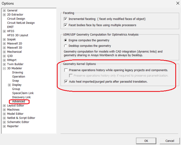

      AEDT changed its 3D Modeler kernel from ASIC to Parasolid starting with version 2023R1.
      As a result, when opening project files created in versions prior to 2023R1 in versions 2023R1 or later, a model geometry conversion is attempted, but this conversion likely fails.
      In 2024R2, select Tools > Options > General Options..., then 3D Modeler > Advanced, and uncheck "Preserve operations history while opening legacy projects and components" in the Geometry Kernel Options section.
      Unchecking this will purge the operation history in the Model tree, but it will significantly improve the conversion success rate.
      With this option unchecked, try opening a 2022R2 project file in 2024R2.
      If simply unchecking this box doesn't solve the problem, try checking "Auto heal imported/purged parts after Parasolid translation" and then opening the 2022R2 project file in 2024R2.

      Thank you so much for your help, but unfortunately, these methods didn’t work, and I encountered over 1,500 errors with both options.

        1. Could you please contact your account manager to obtain a local license (instead of a web license) to access version 22R1? This will allow us to purge the geometry history in 22R1 and then open the project in 24R2.
        2. If you need to proceed only with version 24R2, some geometries may need to be rebuilt. Please run the validation first to identify which geometries have issues. You have to pass the validation before making mesh and run.
