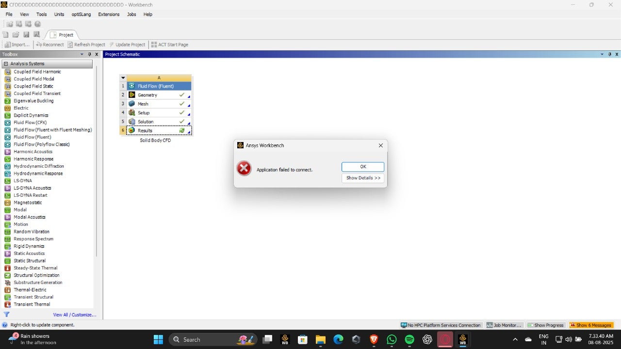

      I’m facing a problem in ANSYS Workbench while working on a Fluent CFD project. The Geometry, Mesh, Setup, and Solution modules work fine. But when I try to open the Results module from the project schematic, I get the following error:
      ❌ Application failed to connect
      Interestingly, when I manually navigate to the project folder and open the .res file using CFD-Post, it opens correctly. So, the result data is not corrupted — it's just not opening within Workbench.
      What I’ve Tried:
      Refreshed the project and restarted Workbench
      Checked project directory and file paths
      Re-solved the project
      Ensured Fluent is installed properly
      Still, the issue persists.

      This is an experience many people share when using Fluent through Workbench. Consider moving to a "standalone" workflow. This is only the tip of the iceberg - you will eventually run into several different bugs or instabilities when working with Fluent+Workbench long enough.

      refer suggestions from following thread: https://innovationspace.ansys.com/forum/forums/topic/application-failed-to-connect-3/
    • Rahul
      If the issue persists, you can try launching a standalone CFD-Post session and loading the case and data files directly into it.
