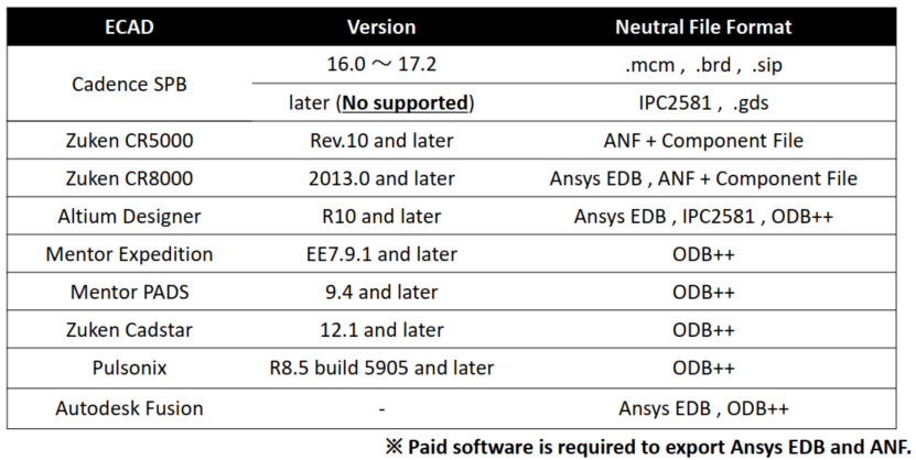

      What ECAD software output the ODB++ file? The ECAD data supported by HFSS 3D Layout is shown in the image below. Are you using an ECAD software that supports ODB++ data?
      Also, Gerber data is manufacturing data and is not suitable for simulation, so we do not recommend using it.
