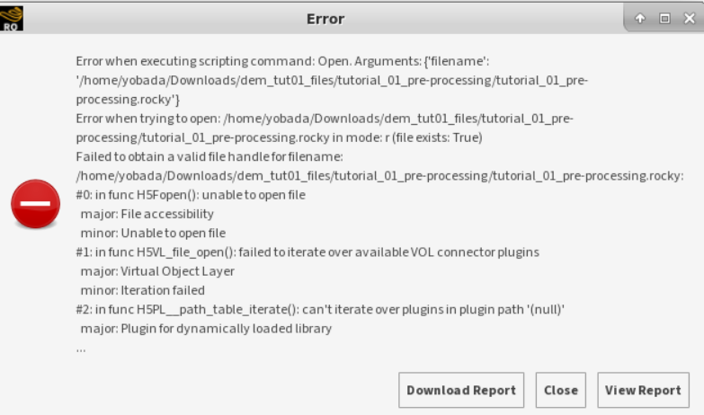

      I am using Ansys Rocky 2024 R2 on a Linux machine.
      From the Rocky interface, I accessed Help → Tutorial Workshops, which opened the tutorials. On the tutorial page, I selected 1. Tutorial – Transfer Chute, and from section 1.1.3 PROJECT CREATION, I downloaded the file dem_tut01_files.zip and extracted it.
      Then, within the Rocky interface, I went to File → Open Project and selected tutorial_01_pre-processing.rocky. However, I encountered an error at this step (please find attached a screenshot).
      I also face a similar issue when trying to save a test case created from scratch.
      Could you please let me know what might be causing this issue?
    • Lucas Bertollo Baggio
      If you're unable to create a new project, I recommend reinstalling Rocky. The current installation may be corrupted. Try uninstalling it, deleting the installation folder, and then installing it again.
