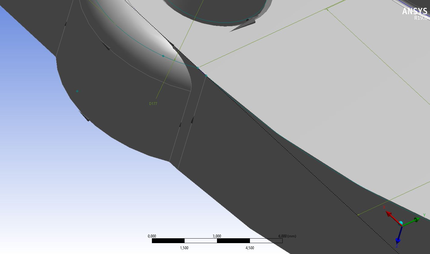

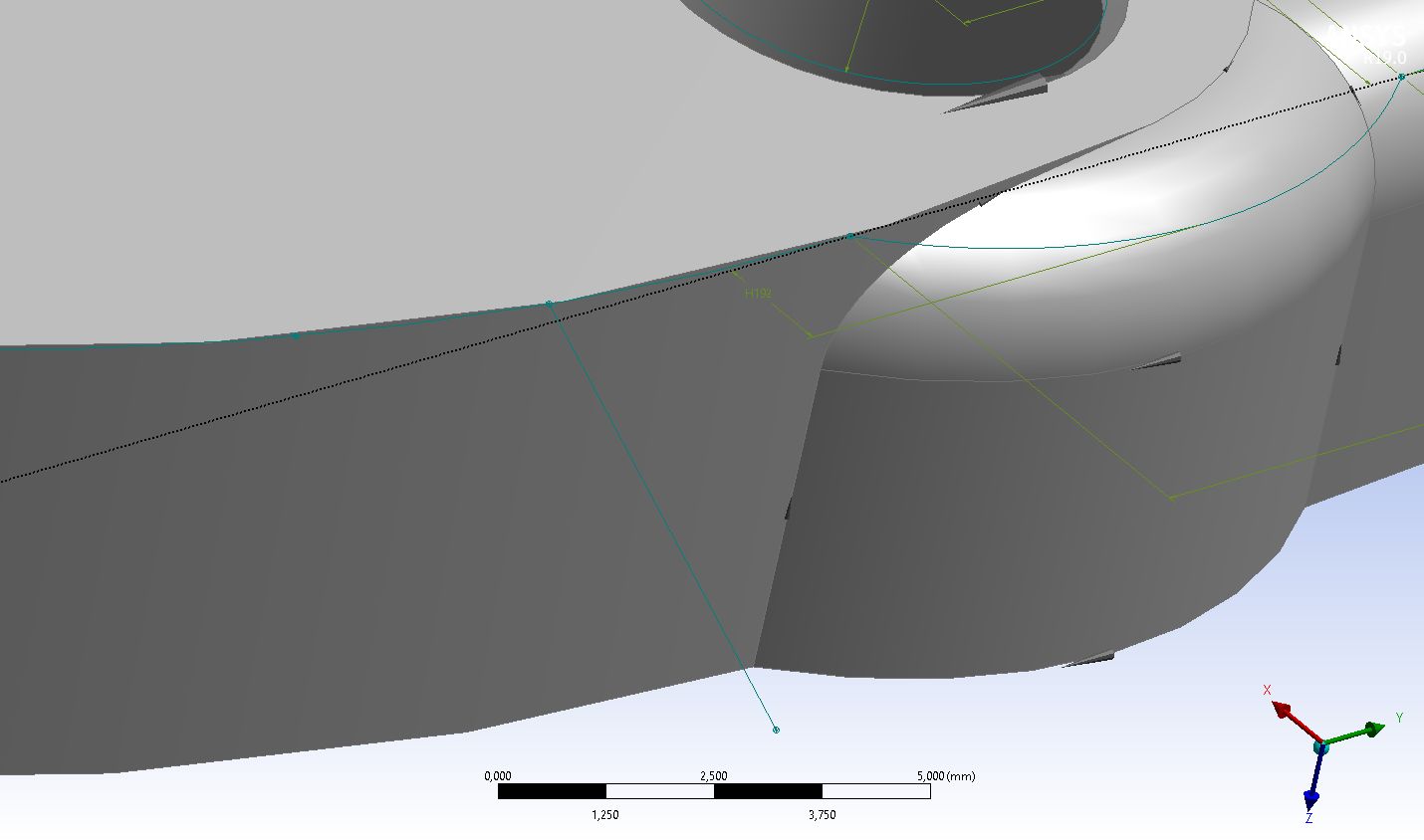

      So at the end, I have to do it a bit differently, so you can see it in the picture, however there is some other problem. Just trying to do the rounded edge, but the whole is not possible. Do you have an idea, what can be the problem. Thanks a lot. The point is that I am not able to finish it all the 90 deg at all.
    • Georgiro
      Of course, if you can tell me how to find out what is the problem and how to make it properly.

    • Keyur Kanade
      it may not be possible as you can see some small feature at the end of edge forming a sharp angle.
      please try to create round for all edges in that loop in one go.
    • Georgiro
      This is great, but I cannot see any problem at this site at all, but three lines having the magnitude on was only 1.86 not 2 mm, which was also interesting in this matter. So till now I have no idea what to do with it.
    • Georgiro
      And I can shouv you the details of the edge to see if you can apprecieve some details. Thanks
