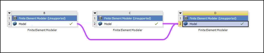

      I want to use the Ansys Finite Element Modeler to import meshes generated by another program. Unfortunately they are coming to me as a bunch of seperate files, each containing a solid with its mesh. If it would be only a few files I could import them each into a Finite Element Modeler instance and then combine as described in this post. I haven't found a solution for importing a larger number of files in one instance though. The picture below shows my importing process where I can select only one file at a time.

      you can use like

      Yes I understood that this is the way to do it as it was also described in the post I mentioned above. In my case I've too many single models I want to connect so I thought there might be a way of importing multiple meshes in one Finite Element Modeler instance instead of loading each mesh into a seperate instance and then combining then. Or there might be another way of achieving this.
