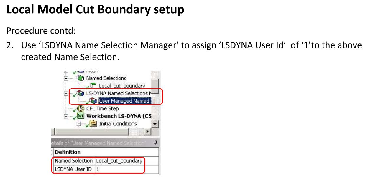

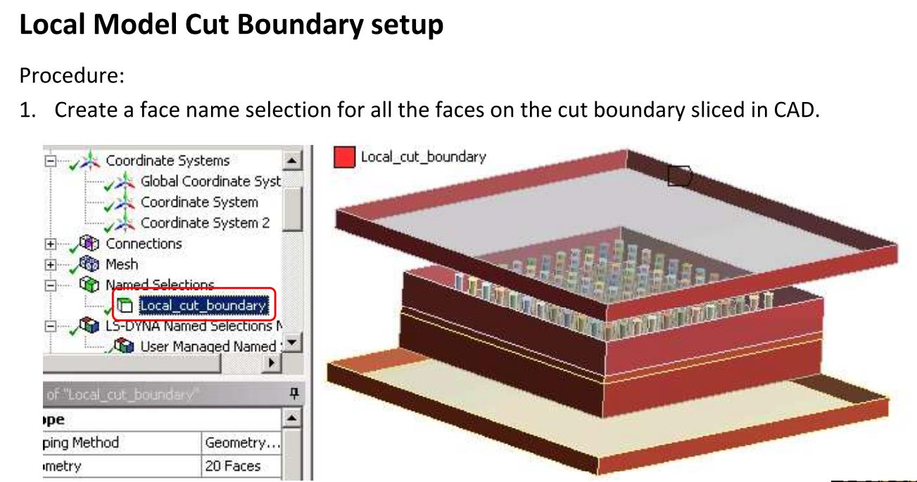

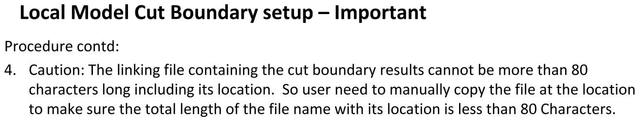

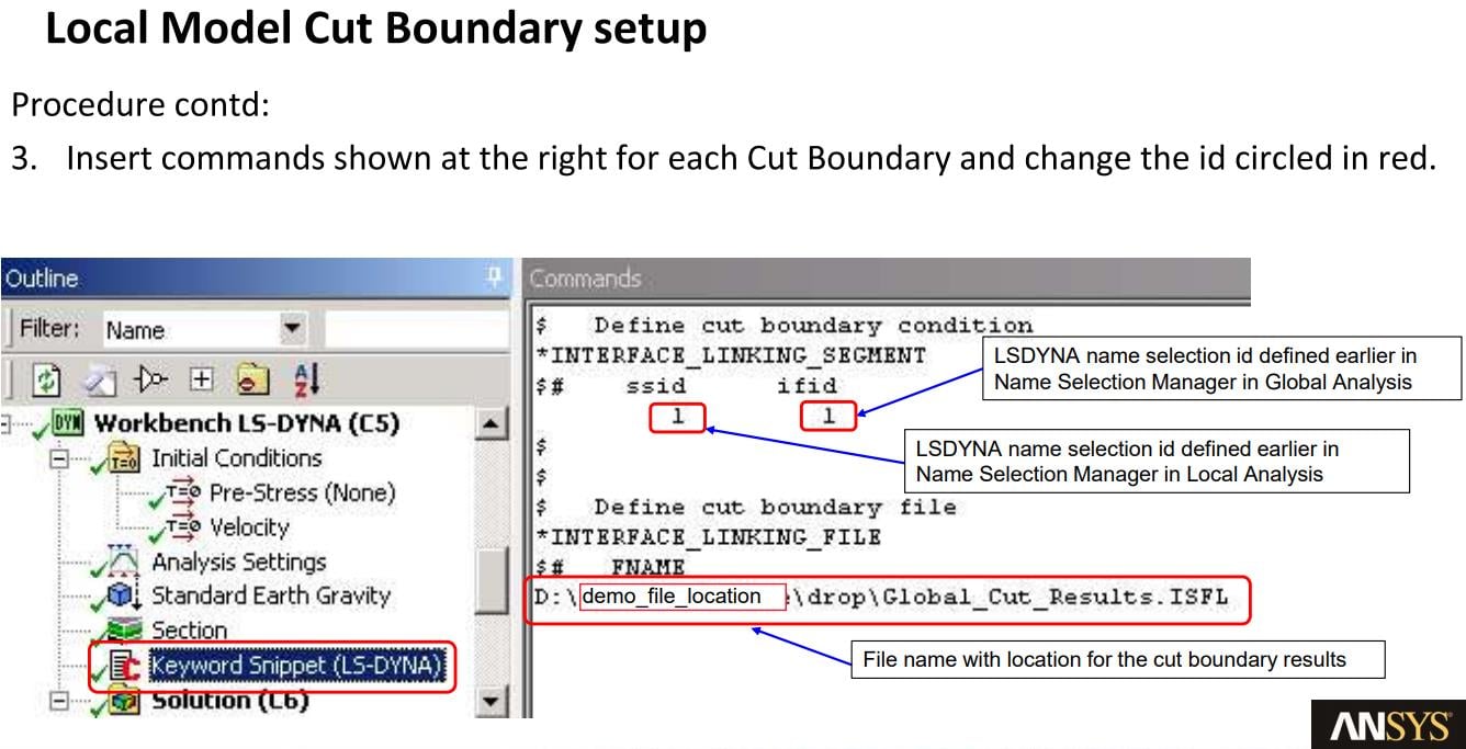

      It is possible but using command snippets. Cut the CAD geometry and create a conformal mesh. Then, try the following procedure:

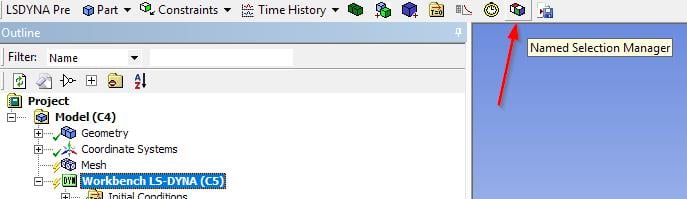

      But I still have a question, may be sounds a little silly. How can I add the ls-dyna name selection manager? I cant find it at GUI of workbench LS-dyna.

      You should be able to insert it from the LS-DYNA toolbar:
      That is a very good observation. Yes, you will hit a limitation with using explicit there. So, select a smaller region compared to what you would use in implicit and don't go crazy with the mesh :-)

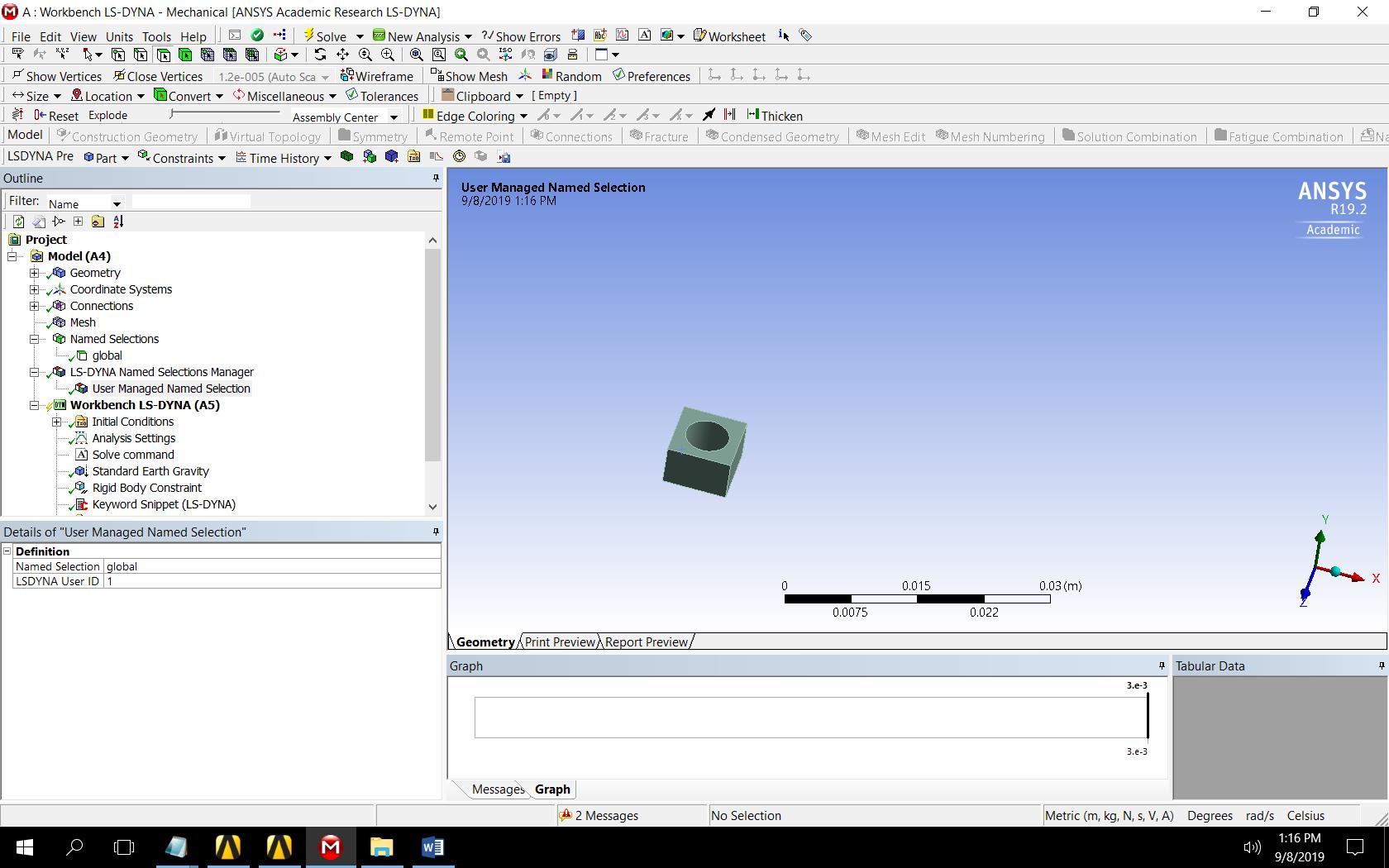

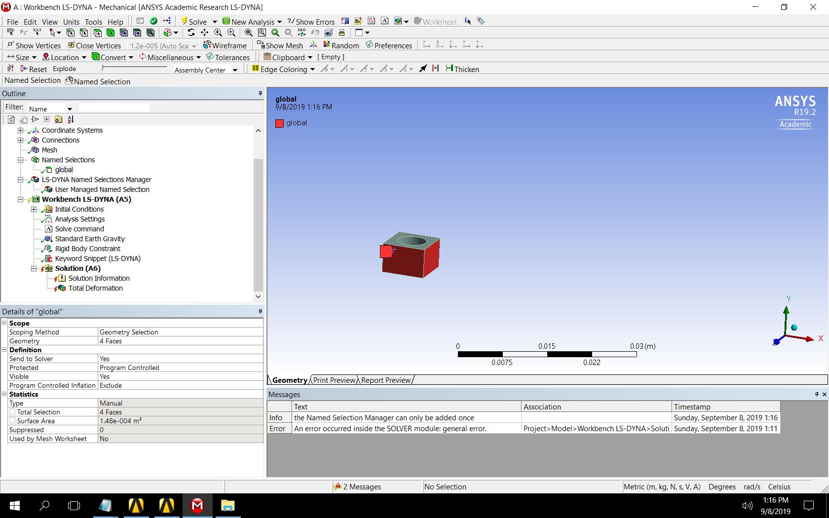

      And should I set the section part before input the keyword snippet?  Does the setting like the below image if I need to set section before inputting keyword snippet? And I found that when I set the section, the LS-DYNA ID is not the same as I set in LS-DYNA named selection manager( it shows in the detail window).Also could you please take a look at the keyword snippet I input, is that right or not?

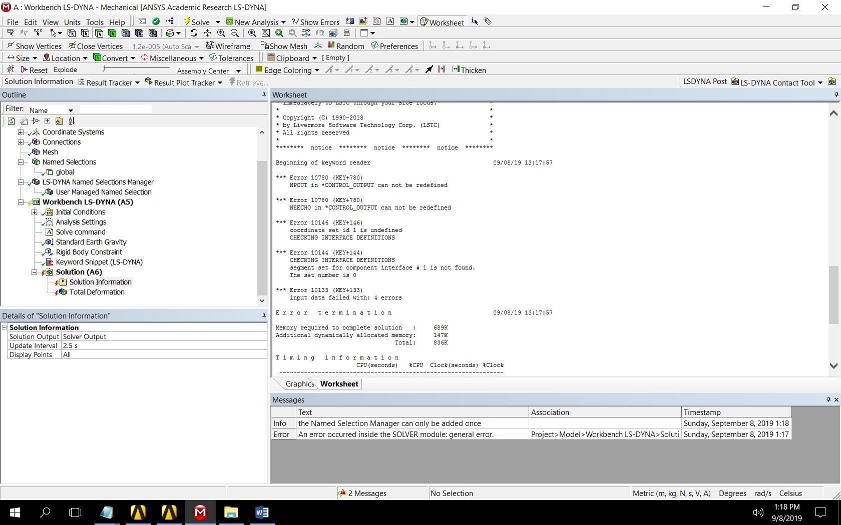

      also, when I solve this sample I made, there will be some errors as below image. it shows there are some problems in the keyword snippet. Could you please tell me how could I solve these?

      Hi San,
      I tried to solve these problems but still cannot find the reason why the interface definitions cannot be defined,  even I also delete the control_output command. I just follow your step which you upload. I attach what I did as attachment. Could you please take a look at and tell me the reason?
