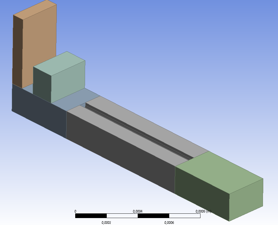

      Hello experts,
      because I can't make this simulation work I wanted to ask if it is even possible to simulate the doctor blading process in Ansys Fluent or by system coupling. In this process a doctor blade (orange) pushes the viscous Fluid (green) into a cavity. I think the deformation rate of the fluid is too high but maybe someone has an idea how to make it work.
      Regards
    • Amine Ben Hadj Ali
      Insert your picture in your text. _What do you mean you cannot make simulation work?
    • rickm98
      In my simulation the doctor blade moves but it just ignores the fluid and the fluid doesn't move with the doctor blade.
      I have dynamic mesh on and have deforming for the fluid activated. Any idea why the fluid ignores the blade?
      Assuming the pale blue block is the blade, where is the fluid region?
    • rickm98
      In this process a blade (orange) pushes the viscous Fluid (green) into a cavity.The block should get deformed by the blade.
      So Orange is a solid blade which needs to push the green fluid. How are you accounting for that in Fluent?
    • rickm98
      That's what I'm not sure of. At the moment I think Ansys Fluent is the wrong software for this simulation but I thought maybe i am missing something
      Do you want to model the fluid dynamics in the "green" fluid domain or just want to account for deformations of the green domain?
    • rickm98
      I want to account for deformation of the green domain
      What sort of fluid is the green block? Note, there are two green blocks so I am assuming it's the one next to the orange one.
    • rickm98
      It has nearly the properties as honey and yes you are assuming right.
      Should be doable with Fluent providing you have the right material viscosity and taking care about the numerics of transfer of displacements and forces :)
