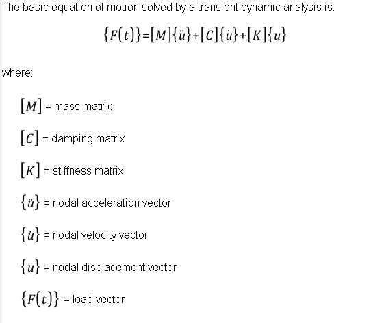

SubscriberHi,nI am running a two-way FSI simulation of a blood vessel using transient structural and fluent. For my engineering data for transient structural I put in Poisson's ratio and Young's modulus for the vessel wall. However my simulation will not run unless I put in a density for my vessel wall. Is this absolutely necessary? The literature I have read does not cite using a density for the vessel wall, only for the fluid (blood) which I have. Is Young's modulus and Poisson's ratio not enough to run the transient structural simulation?nAlso just in case this information is needed, I put in fixed supports and fluid solid interface on my geometry for Transient Structural.nThanks!n -

Forum ModeratorTransient will need the density because it will be needed for solving mass matrix in the equation:nmore info at:nhttps://ansyshelp.ansys.com/account/Secured?returnurl=/Views/Secured/corp/v201/en/ans_str/Hlp_G_STR5.html n-AniketnHow to access Ansys help linksnGuidelines for Posting on Ansys Learning Forumn
