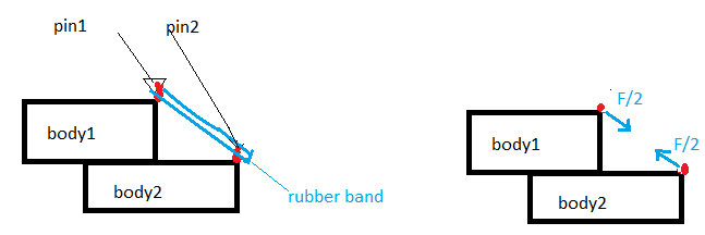

SubscriberTo better explain the question consider a rubber band between two pins each one belonging to a body. Look at the attached picture

SubscriberHi first of all thanks for your answer.
Actually, the geometric model does not include the pins. They should be modelled and unified to the bodies, that's why I thoght to apply a remote force since it allows to specify the location for the scoped region. In my case, the location is a face of the body (where theoretically should be the pin) and the point given by the coordinates of the pins.
Regarding the boundary condition, by looking at the image, the top face of the upper body was constrained by a fixed support. Since the two bodies are in contact that constrain should be enough to avoid rigid body motion.
My doubt was also about the type of contact. The two bodies could slide on each other, but not separate. So since the action of the rubberband is to avoid separation maybe it could worth replacing the contact by a frictionless one, that instead allows separation, otherwise the effects of the rubberband could not be visible. Don't you think?

Subscriberthanks again. The contact point is clear. But there is an issue regarding the force.
Let me be clearer about the simulation. Maybe I didn't say that I will not include the rubber band in the geometry. The geometric model includes only the two bodies. There are no pins, no rubber band. Thus, the idea is to approximate the behavior of the rubber band (that is inserted between the two pins) by applying a couple of equal and opposite internal forces (remote forces) acting on the faces where should be (but are not present) the pins. IIf I use a force load ( and not remote force) I cannot define the point to scope the force (that is the global coordinate of the pin) since the force can be scoped to a geometry and a named selection, but how can I scope it to the point corresponding to the x, y, z coordinates of the pin? If I insert a remote point it would require a remote force, thus is there a way to scope the force to a point that is not included in the model?

SubscriberI know the magnitude of the force associated with the band at its maximum length, that is corresponding to the distance between the two bodies. So the model depicted in the picture represents the ultimate configuration in which the ban is at its max stretching, thus the force is maximum. So, according to my opinion, there is no need for modelling the band since I want to evaluate the transfer of the load to the bodies to detect the stress. If I am wrong please let me understand why.

SubscriberThe attachment from your original post is inserted here for ANSYS staff to see, who are not permitted to open attachments.
A rubber band is like a spring, when stretched to come distance it generates a force F.
When you want to represent the effect of the force F, each body sees the force F. It is wrong to divide that by 2 just because you are cutting out the band and replacing it with a force.
I suggest you represent the rubber band with a spring element.

SubscriberHi Peteroznewman can you make it clearer the reason why the force should be F and not half per side?
Thanks
September 2, 2021 at 5:11 pmpeteroznewman
SubscriberSay you have a 100 cm long rubber band. Anchor one end to a pin and put a force sensor on the free end.
Stretch the free end by 50 cm (strain = 0.5) and find the force is F.
Cut the rubber band down to 10 cm and stretch it by 5 cm (strain = 0.5), the force is still F.
Cut the rubber band down to 1 cm and stretch it by 0.5 cm (strain = 0.5), the force is still F.
If you replace the pin-anchored end with a force sensor, it will also measure F.
