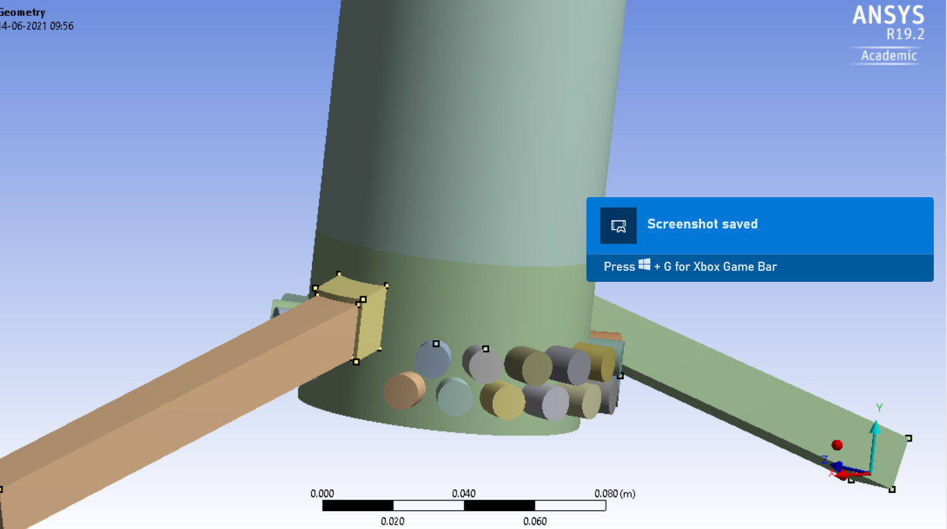

SubscriberHello everyone, I'm trying to mesh this body (big cylinder divided into two parts + small cylinders + rect ducts).
June 15, 2021 at 11:13 amKeyur Kanade
Ansys EmployeeI think you already have similar post.
You will need to use only one session to get conformal mesh.
Please make sure that you have those cylinders and rectangles as different bodies in SpaceCLaim.
Then use Share topo and then go to meshing. In meshing make sure that you give Named Selection to common face.
Regards Keyur
