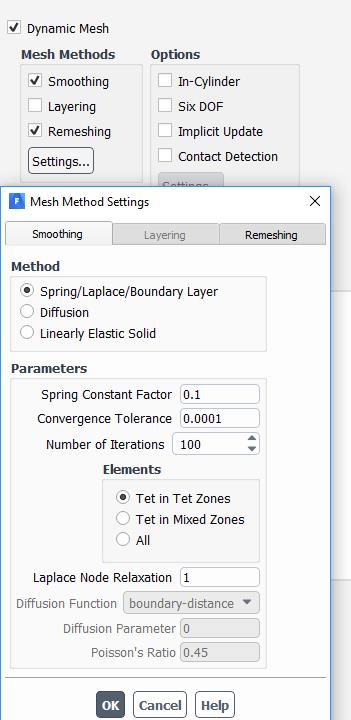

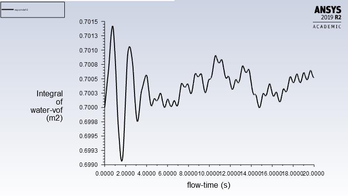

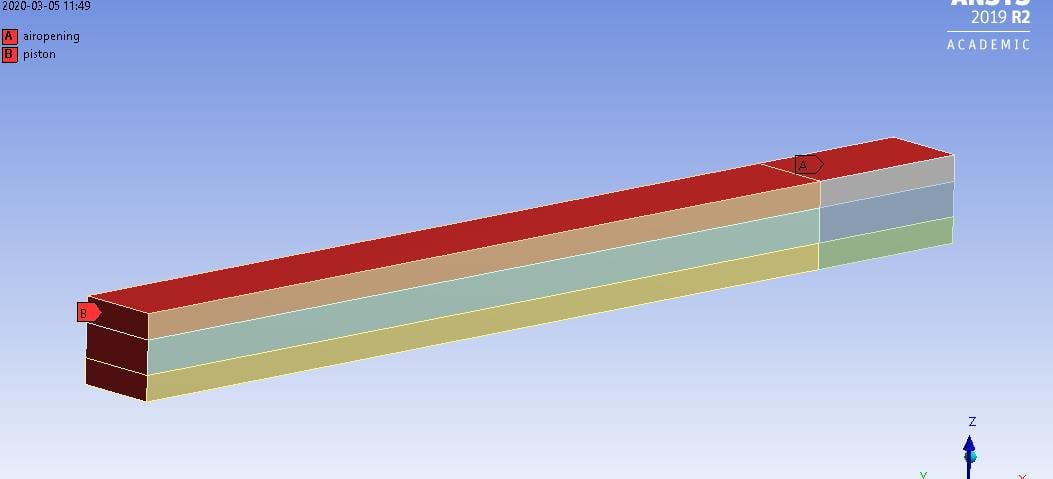

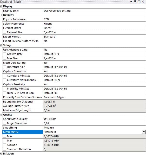

I am very new to ansys and trying to implement the flap type wavemaker. For my geometry the wavetank has height in Z direction and length in X direction and width in Y direction. I want a regular wave which i can validate through wave theory. Although as u can see from the result its irregular. I want to know if i am doing some mistake in code or is it the setting for dynamic mesh which is wrong. Please provide me with some feedback for improving my wave through flap motion. Thank youÂ

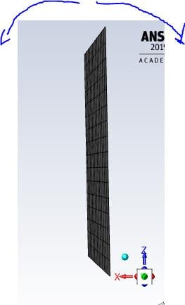

SubscriberI want the motion of the Flap in a way the it is applicable to my 3d model. Should I try to make two code for defining each direction?

Subscriberyeah i can make it vel[0] for motion although it act as pistion motion as I have taken face loop. I wanted to have flap motion so I chose omega but when taking omega[0] the motion is not like flap. So I choose omega[1] which relates to my model.

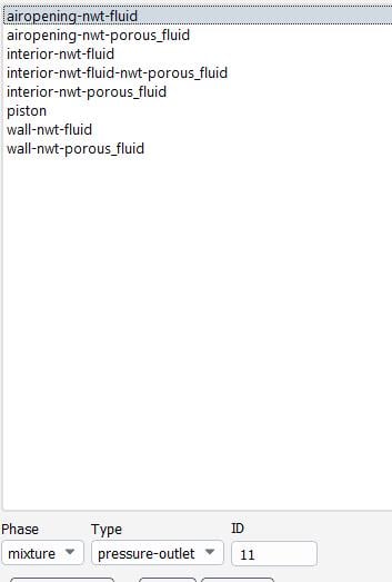

SubscriberIn boundary condition I have just pressure outlet which is assigned to airopening. The motion is through UDF file which is assigned to rigid body piston.
