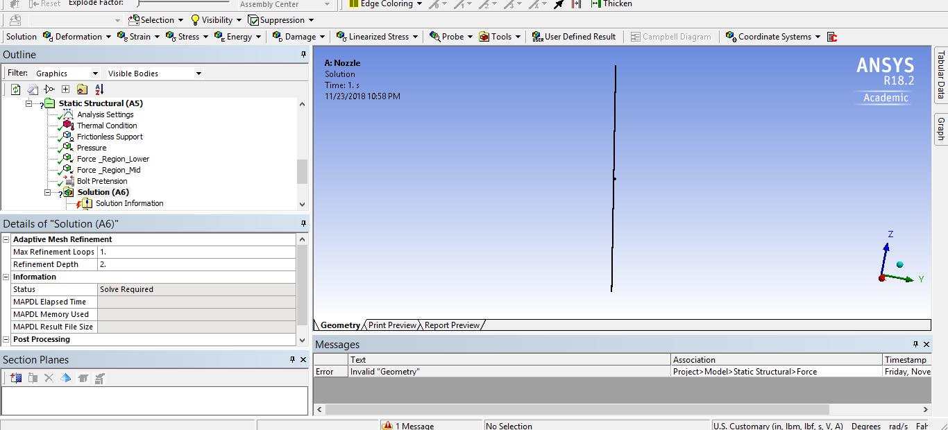

      After filling up all the conditions on bolted nozzle flange as on edx course and click on solve button error message shows with text Invalid "geometry" and Association Project - model - static structure- force.but i can't find any default on force section.anybody help please

      Delete the two Forces from Static Structural branch.
      Hide all bodies but Lower. Create a Force on the Lower.
      Hide all bodies but Mid, Create a Force on Mid.
      Click on Mesh and Clear Generated Data.
      Click on Solve (which will mesh first).
      Did that help?

      Elias,
      You left in a Force that had a ? due to it not being finished. I suppressed that.
      I added a Coordinate system for the 360/400 degree face.
      I added two Symmetry Regions.
      I cleaned up the contacts, which had too many bonded contacts, one that was changed to Frictional.
      It now solved. I didn't check if all the inputs were correct and you get the right result, only that it solved.
      Peter

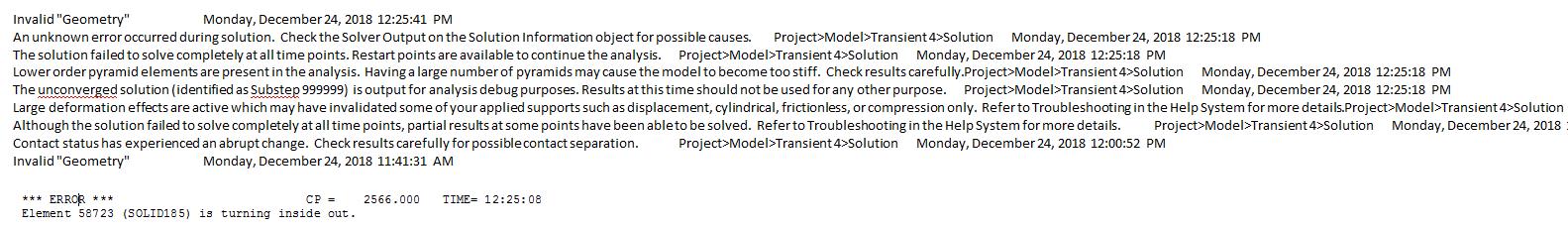

      the modal analysis is running fine. I tried to run the saw tooth shock with 20000g for 11ms. When I try to run the solution(/click solve) it throws an error of "Invalid geometry", the solution start running for some time and terminates. Please help for solving this problem.
      load definition is done using time steps. please define setup for above requirement.

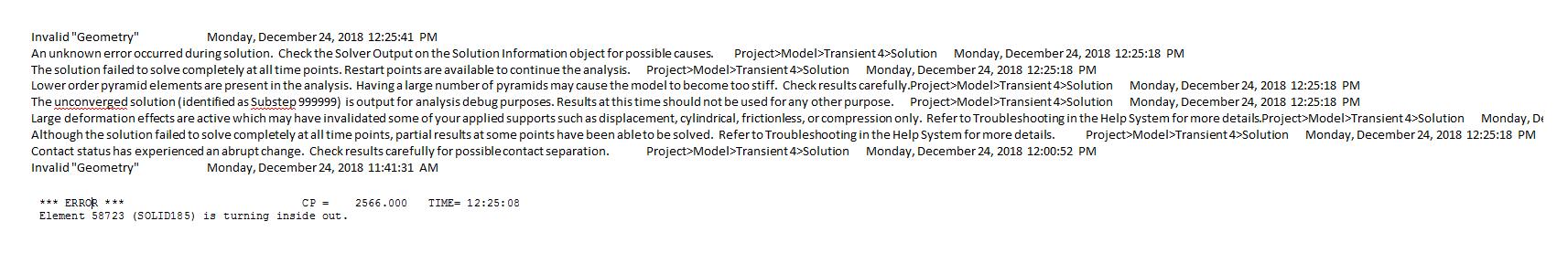

      Hello, I am a new Ansys User, and in a Workbench Project i have to simulate a pin-on-bearing wear : i created the geometry of both parts (Pin and Bearing) in NX 11.0 and exported the file .STEP to Ansys to simulate it. The meshing works perfectly, but when i click on solve button, i get an error message showing (Invalid "geometry"). i was first using Ansys R15 then changed to the version R19. Please tell me what i am doing wrong ? Thanks.
      The image shows you used an IGES file, not a STEP file. IGES is the worst exchange format from NX 11 to ANSYS.
      It is best to export a Parasolid out of NX 11 and then in DesignModeler, Import External CAD Geometry.
