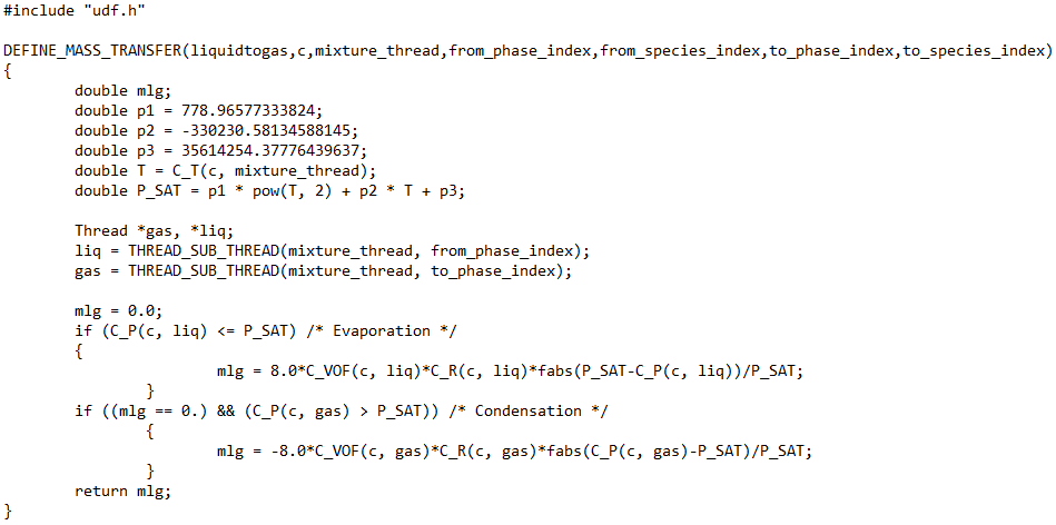

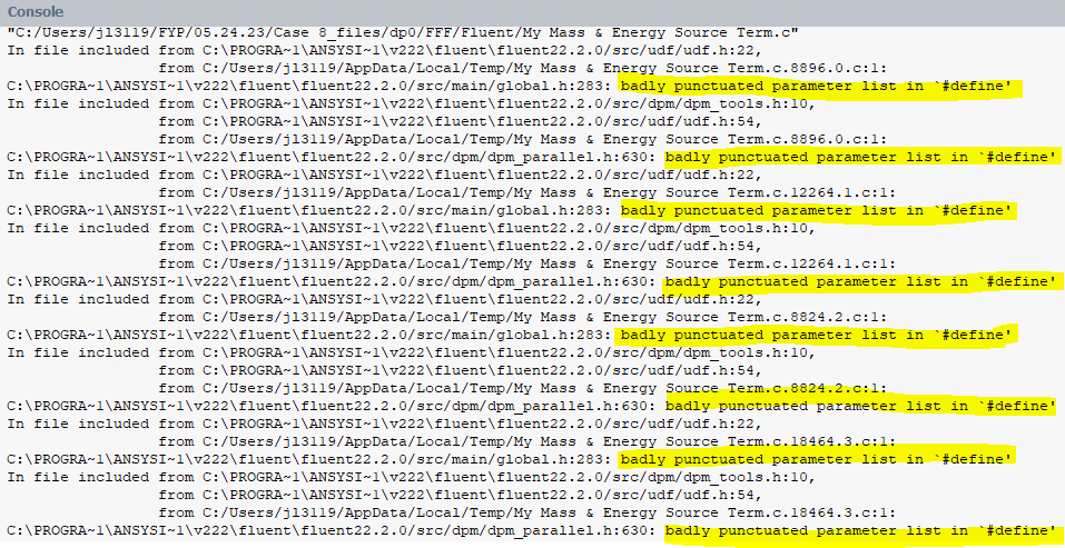

      When interpreting my mass transfer UDF, the console repeatedly prints a message saying "badly punctuated parameter list in `#define'". I have attached an image of my mass transfer UDF and the message printed in the console. What have I done wrong? Am I allowed to interpret this UDF or does it need to be compiled?

      It's generally better to compile, mainly for speed but the error reporting can be more useful. Not all macros can be Interpreted.  If the macros are available to hook up then it worked, but I'd go through and find out why there's a warning.

      I understand it is better to compile but given my UDF (see above image), can I interpret? Can the macro I use in my UDF be interpreted?

      The manual usually states if it must be compiled. The interpreter usually fails too if the macro needs compiling.
