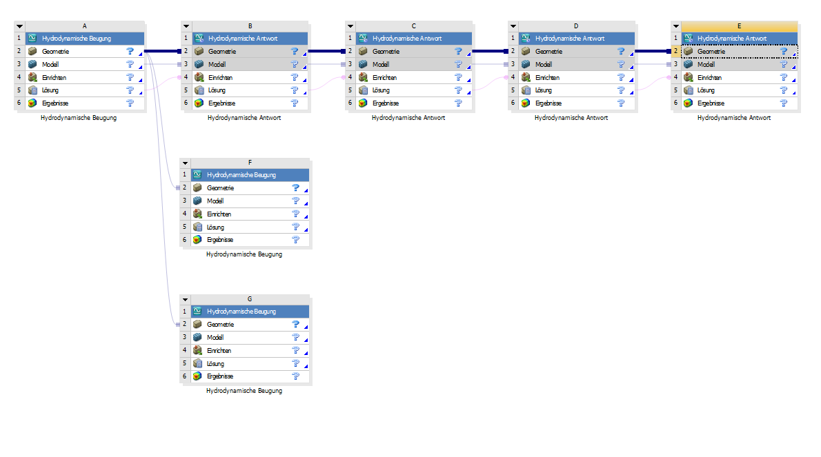

      The answer to this depends on the relative ship motions in the stability analysis (equilibrium position calculation) and/or the time response analysis.
      If the ships are moved relative to one another in the equilibrium position calculation, then you should use Part Transforms (right-click on each ship and Add > Part Transform) to move them closer to their equilibrium positions for the Hydrodynamic Diffraction analysis.
      For example: Ship 1 is originally positioned at X = 10 m, Ship 2 is originally positioned at X = 230 m. The equilibrium calculation moves the ships to X = 40 m and X = 190 m, respectively. Add a Part Transform to Ship 1 to move it +30 m in the X direction; similarly for Ship 2 to move it -40 m in the X direction. In this way the definition positions of the ships in the Hydrodynamic Diffraction analysis will be closer to their equilibrium positions, and you are less likely to see warnings related to hydrodynamic interaction in the time domain.
      If the ships move relative to one another in the time domain, this is harder to fix. The recommended approach is to create a separate Hydrodynamic Diffraction analysis for the ships in their transient positions, then use a Python pre-solve script to load the hydrodynamic database from this additional Hydrodynamic Diffraction system into a second time domain Hydrodynamic Response system.
      For example: Ship 1 is originally positioned at X = 10 m, Ship 2 is originally positioned at X = 230 m, and there is no change in relative position during the equilibrium position calculation. After 3600 seconds of the time response analysis, Ship 1 has moved to X = 40 m and Ship 2 to X = 190 m. To avoid inaccurate time domain results, a separate Hydrodynamic Diffraction analysis is defined, in which Part Transforms are used to move the ships to X = 40 m and X = 190 m respectively. A second time response analysis is linked to the first, with a Start Time of 3600 sec, and a pre-solve script is used to import the hydrodynamic database from the additional Hydrodynamic Diffraction analysis. In this way the hydrodynamic interaction effects are 'updated' for the new ship positions.
