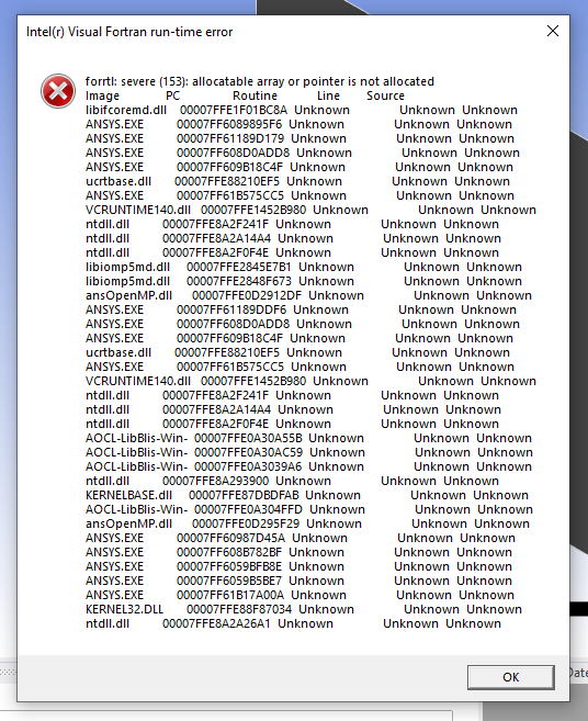

      Hi guys,
      I am using 2022 R2 student version for my current thesis and ran into the error message mentioned above and shown in the first image:

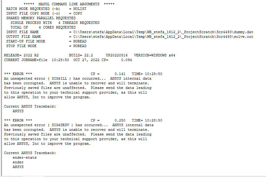

      After checking the solver output the following two errors appear:
      I checked so many different options already and nothing worked out for me. Help would be very much appreciated, thank you!

    • George Karnos
      Do you have Aspen installed on the same machine?
      The issue can be caused by Intel MPI dll files placed under C:\Windows\System32 by ASPEN V11.0 which is conflicting with the Intel MPI libraries of Fluent.
      To resolve the conflict either update ASPEN to V12.0 or Run these commands from an Admin CMD:

    • Yaqi Deng
      Hello George, i have same problem but i didn´t install Aspen. How can i solve this problem instead?
    • danny
      I am also having this error without Aspen installed.
    • Marzieh Taghipour
      Hi guys,
      Have you found any solution? I am facing such as the error.
    • Moritz Seidel
      Hi, I have the same error messages and also NO Aspen installed. Does anybody know a solution?
