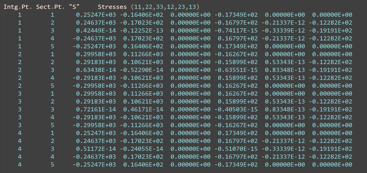

    • Akshat Gupta
      With the 'OUTPR,ESOL,LAST', I am able to get the stresses as the integration points.
      Sample Below.
      Best,
      Akshat
    • 2020221038
      Wow, you are showing this correctly, you have what I want. Can you send me the relevant commands to learn? I'm still not getting it right here.

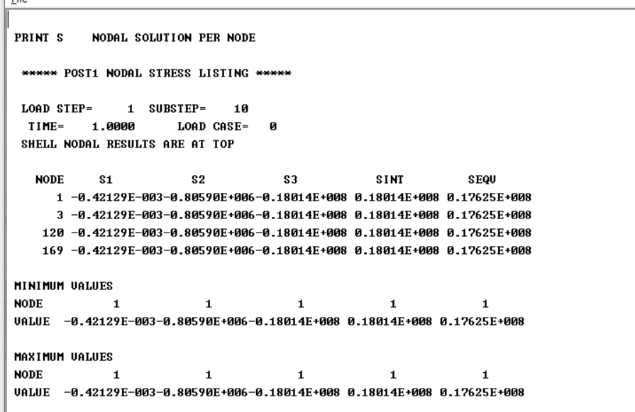

      /post1
      esel, s, , , 1
      nsle, s
      PRNSOL,S,PRIN
      OUTPR,ESOL,LAST

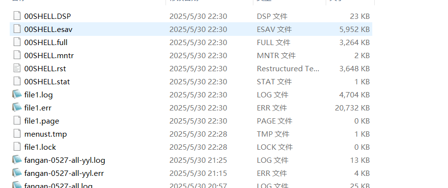

        Can you tell me how to export the solve.out file? I try to export but I don't have your very perfect result.Thank you very much.
    • 2020221038
      Hello,but I don't have a solve.out file here.
    • Akshat Gupta
      You can have a look at jobname.out file in the solver directory.
      Do you see such file with .out extension in the directory?
      Thanks,
      • 2020221038
        Thank you for your answer! I've looked at the working directory, but there are no such files with the .out extension.
    • Akshat Gupta
      Ideally, due to the second command "/filname,00 SHELL", the jobname becomes 00SHELL, so you should see a file named 00SHELL.out in your directory. It is essentially the output file where we are also requesting printing of the ESOL via OUTPR command.
      Maybe you can try removing that command once. What is the job name you have given in the execution line of APDL?
      That name can be checked too. By default, APDL launcher takes 'file'.
      Thanks,
      • 2020221038
        I reran it but there is no file in this format, and I have not seen this format during previous runs. Can you send me that command you ran to learn it?
    • Akshat Gupta

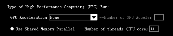

        Thank you very much for your reply, I have tested what you said and it still doesn't work. I have tested the /output position as well and it still doesn't work. Does this have anything to do with the High Performance Computing Setup? It seems to me that the previous files with output were using distributed computing.

        When using distributed computing, there will indeed be out files, just records that can write the base information, but still no result output. There is a big gap with your output.

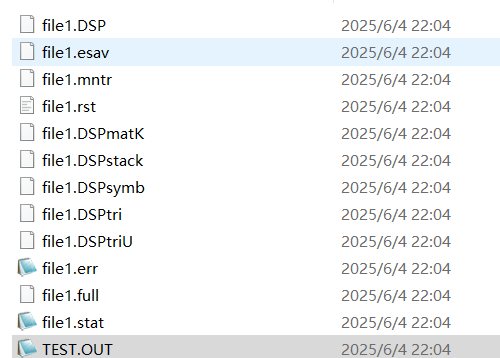

      Can you try using the commands below with SMP

      Please try this and let me know.

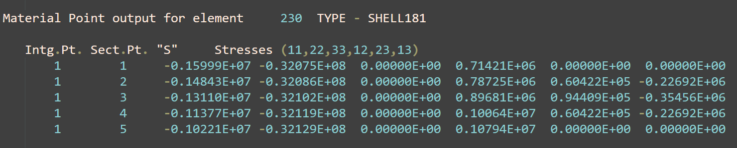

        Hello! I noticed that the out file results do not include the principal stress results, only the results below, but there is no relevant explanation in the esol documentation.
        “S”     Stresses (11,22,33,12,23,13)
        “EPTO”  Strains  (11,22,33,12)
        “EPEL”  StrainsEL(11,22,33,12)
        My structure is cylindrical, and I want to extract the radial strain and principal stress at the integration point.
    • 2020221038
      I ran the command you posted and it automatically generated the out file. In the help it mentions:By issuing the /OUTPUT command before SOLVE, you can divert the output to a file instead of the screen.
      However, in the solution phase, performing /output before solving doesn't result in an out file, only in the preprocessor phase?
