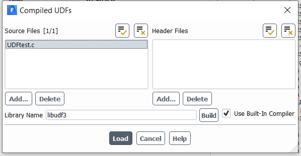

      Hello, I am hoping to create a UDF for ANSYS Fluent 2020 R2, and have installed VS 2019 for reasons that aren't fully clear to me, as most tutorials I have seen involve using a simple text editor to create basic UDFs. However, when I try to load the function, I get the following error:nNo version of Visual Studio compiler found - C/C++ compilers most likely not set correctlynFile C:\Users\itb7\Documents\ansys projects\udftest2_files\dp0\FFF\Fluent\libudf\win64\2ddp_host\SConstruct, line 5, in nnIt seems that the VS 2019 needs to be set up to work with ANSYS somehow, but I can't find any information on how the setup process actually works. I would really appreciate any advice!n
    • ANSYS_MMadore
      itb7 Please install Visual Studio 2019 with the options noted in this screenshot.
      Thank you,
      Matt

      mmadore I've made a new folder without spaces and set up a new project to test this out. The process I've been using to compile the UDF is exactly as you describe, and I've been checking off the box that says "use built-in compiler" in the popup menu. I've attached the Fluent console output in the notepad file.
    • itb7
      Array just wanted to follow up on this problem-- I attempted compiling a blank .c file as a UDF and it didn't return the same errors, but as soon as anything else gets put in I still receive the message that the C compiler is not set correctly. Do you know of any other way I could fix this issue?
    • ANSYS_MMadore
      Array Can you try without the "use built-in compiler" box checked?

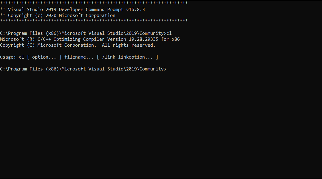

      1. Open up the Visual Studio 2019 x64 Native Tools Command Prompt window and change to your working directory where your case and data reside.
      2. Create an ANSYS Fluent v1xx.x shortcut on the desktop
      3. Drag the ANSYS Fluent shortcut into the x64 Native tools Command Prompt window.
      4. Press Enter
      5. ANSYS Fluent launcher opens.
      6. Go to Environment tab and uncheck "Set up Compilation Environment for UDF"
      7. On the "General Options" tab, make sure your “Working Directory” is set to the location where your case, data and UDF is located in.
      8. Launch Fluent and try to compile a UDF, with "use built-in compiler" unchecked.
    • itb7
      mmadore built a new simulation in a new folder to make sure any previous settings wouldn't interfere. I otherwise followed the instructions above, and everything described was exactly where specified. It looks like the error generated is slightly different, and rather than saying "C directory is not set up properly", it says "not compiled for parallel use on the current platform." I will try and set it up on one core of the computer to see if it will at least work under those circumstances, although I don't think I can run any practical simulations in this manner. I'm attaching the Fluent output below.
    • itb7
      mmadore output from running Fluent without parallel computing is below.
    • ANSYS_MMadore
      Array Please open the Visual Studio 2019 x64 Native Tools Command Prompt and enter "cl" without the quotes and send a screenshot of the entire window and output.
    • itb7
      mmadore
    • ANSYS_MMadore
      Array Can you try running Fluent from the command prompt again and compiling, but instead use the "x64_x86 Cross Tools Command Prompt for VS 2019" rather than the "x64 Native Tools Command Prompt"?
    • itb7
      mmadore it seems to have returned the same error.

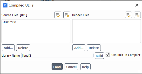

    • itb7
      mmadore It looks like it was a user error; my mistake was that I did not have the UDF selected while pressing "load". Below I am attaching the steps used to get the function to load. Now I just need to get my function itself to work!
      Easily done, select the .c file and Build. Once the TUI stops doing things (issuing gibberish and warnings for the most part) then Load.
      Build creates the library, and Load opens it in Fluent.
    • sumykk
      I still have error
    • sumykk
      It worked once but idk y it doesn't work anymore
      If you loaded the library then tried to change the .c file you may struggle to rebuild the library. Unload the library then rebuild: it's a feature of Windows where we can't overwrite a file that's in use.
