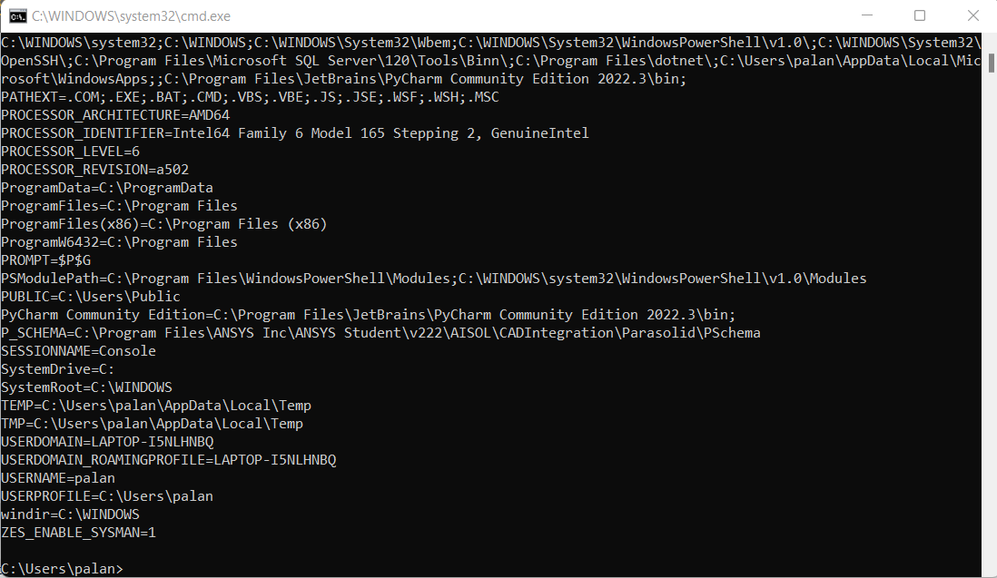

      If you still have an issue, please send the screenshot of the output of the command 'set' (without quote '') in the CMD Prompt.

      below is the output of the prompt for the set command:
      output command set
      output command set 2

      Thank you for the info. This helps eliminating the 'other' issue that I was thinking about.
