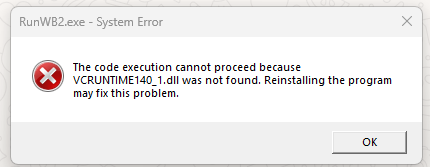

        Hi All, I am trying to install ansys 2025R1. I have attempt multiple time as it says reinstalling may fix the problem.  but unable to use the softwere. any hint will be much appriciated    :)

      The error indicates Visual C++ 2015 redistributables are not installed. Please uninstall Visual C++ 2017 redistributables and install the Microsoft Visual C++ 2015-2019 Redistributables for x86 and x64.
      Available at: https://support.microsoft.com/en-us/topic/the-latest-supported-visual-c-downloads-2647da03-1eea-4433-9aff-95f26a218cc0
