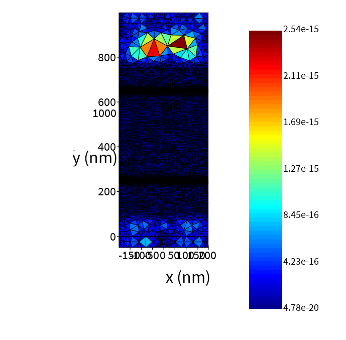

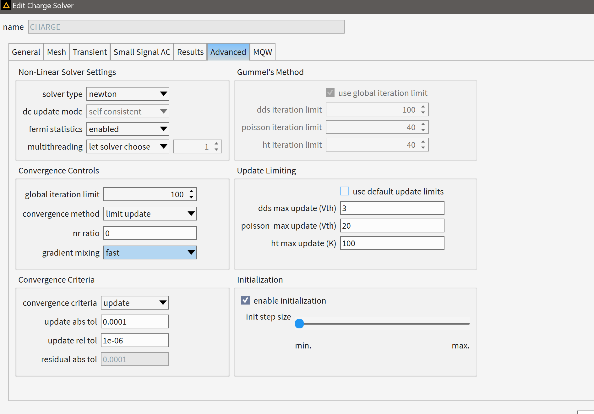

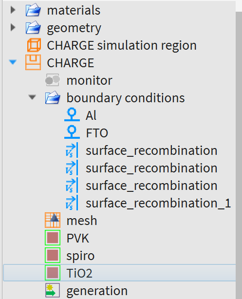

      Now I have imported the. mat file generated by solar_generation in FDTD into CHARGE. May I ask what settings are needed for the CHARGE model? My current problem is that the initialization failed to converge, but after reading the official manual, it was not resolved. It may be a setting issue. Besides the ones in the figure, what other settings do I need to add or modify to the model.

      Convergence issues can be caused due to several reasons like the mesh, material models, and so on. It might be a bit challenging for me to identify the root cause without having a look at the simulation file.
      My first question would be, are you able to get past the initialization stage with the "generation" object disabled/under dark conditions? Can you send a screesshot of the mesh/grid after the meshing stage? Also, are you using any advanced material models like high-field mobility/impact ionization?
      My recommendation would be to simplfy the simulation, such as disabling the surface recombination boundary conditions, the optical generation rate, turning off any advanced material models. With these disabled, check if you are able to solve the convergence issue. Then you can enable these models/parameters one by one and narrow down on which input parameter is causing the convergcne error and then we will discuss how to address the error.

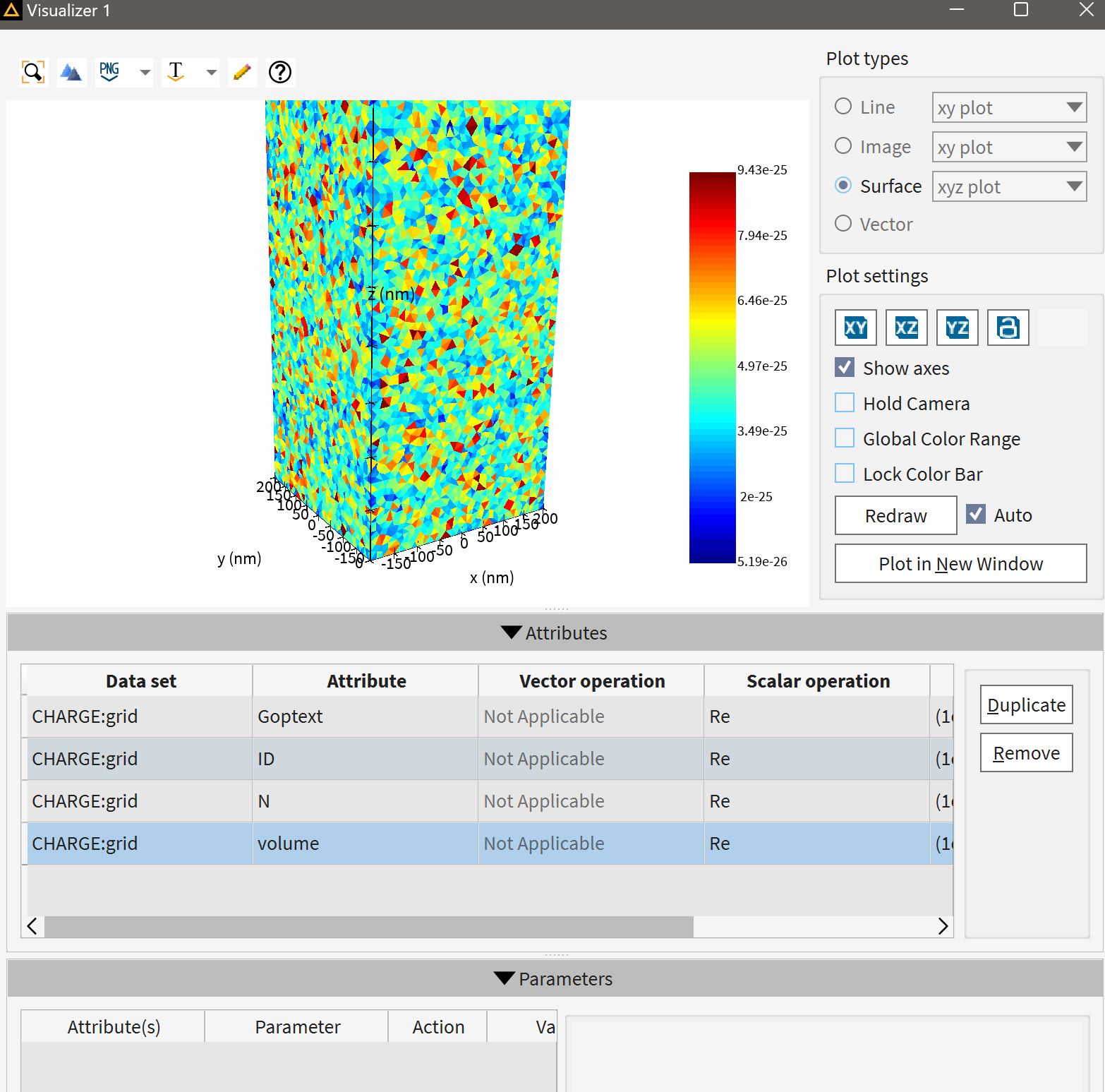

      Then I would recommend trying to resolve the convergence error without the generation object first. Also, are you able to get convergence for a 2D slice? In general, it is harder to attain convergence in 3D simulations so it is best to go into the final simulation after we can get the simpler configurations to converge.

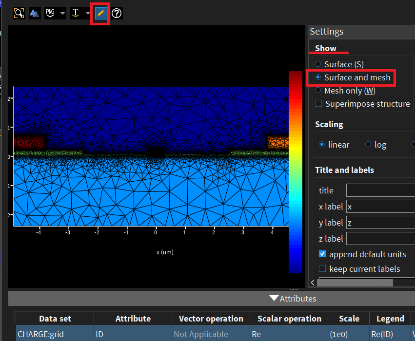

      The mesh screenshot doesn't give any useful information. I believe it is because we are seeing the exterior surface and the fetaures are on the interior. Also, I would recommend visualizing the mesh with the "Show" "surface and mesh" option:
      It can tell you if each feature is being properly resolved (or too resolved) or not. Are you starting the voltage sweep at 0V? Are you using any mesh override? What is the overall simulation size and what is the mesh size? What is the thinnest layer?
