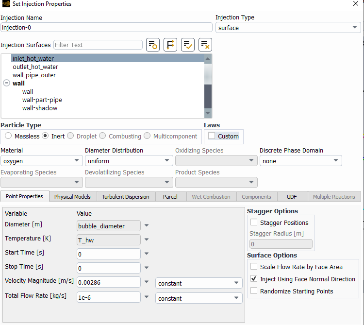

SubscriberI had a look at DPM and I tried it also. Some points are not clear to me:Â
- the surface injection of bubbles from inlet. Are the particles considered as inert?Â
- Point properties: how to specify velocity and mass flow rate? Is for example drift flux model a way to estimate their values?Â
- Â Â steady and unsteady tracking is not well explained in the manual. When can I use the unsteady one?

January 12, 2023 at 2:50 pm
Monta
SubscriberÂ
I don’t know exactly what you mean by options. As you can see here I have to input values for velocity and mass flow rate. That’s why I asked about empirical models (like DFM) to estimate both values. Another questions to start and stop time. Is is it just the begin and end of simulation time for example?
January 12, 2023 at 4:08 pm
Rob
Forum ModeratorTime is often zero to a large number: it's more useful when injections are only wanted for short periods. You will know the mass flow of spray/particles/bubbles and for a surface using the inlet velocity is sensible.Â

SubscriberI tried the injection only at t=0s. It works but it seems not realistic since the bubbly flow enters the pipe contiuously with new bubbles. Moreover I want to know how does Fluent compute the number of tracked particles.Â
January 13, 2023 at 9:41 am
Rob
Forum ModeratorSo you need time 0
January 13, 2023 at 9:56 am
Monta
SubscriberHow about the number of tracked particles. How does fluent compute it? Is there a formula based using flow rate, bubble size/properties and velocity?Â
January 13, 2023 at 11:07 am
Rob
Forum ModeratorWeird, I posted a lot more text.Â
Injection will be 0 < t < 3600 or so, ie bubbles are injected every particle time step for a continuous injection.Â
For a surface injection you get one parcel stream per facet. The parcel speed is based on the values you put into the panel. The parcel mass is injection mass divided by the number of parcel streams. Leave the parcel definitions alone until you understand what the changes will do.Â
