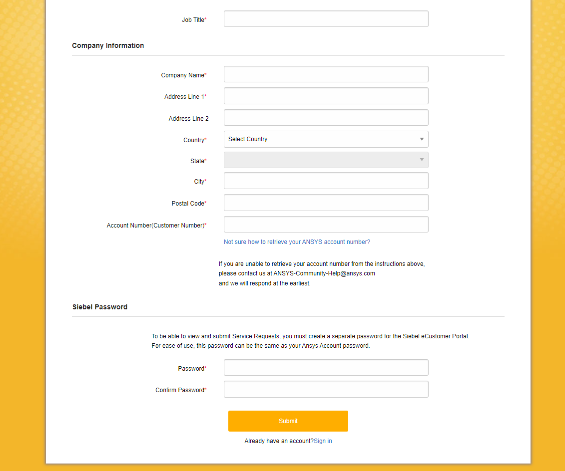

[EDIT] i can't acces url cause it redirect me on the create account page where i'm asked to give license key product, but i use ansys etudiant version and i can't find my license key ..

SubscriberPlease check the 2nd link provided by Supreetha.Â

Nikhil N
SubscriberMake sure you follow the 1st step before pasting the link.
- First open the help section of Ansys through the software ( ? button on the upper-right side of the Fluent Solver User Interface: This opens help in a browser)

charles-web
Subscriberok thanks i did a misunderstood on my first read
