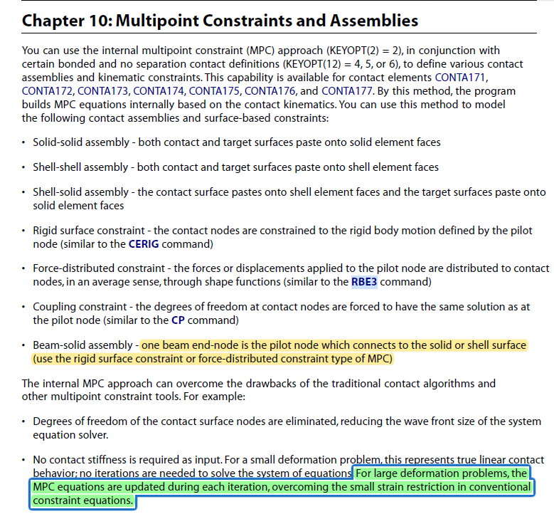

February 14, 2022 at 3:24 pmJJ_Thompson
Subscriber@Rameez_ul_Haq, you should take a look at the ANSYS contact technology guide. See the point I highlighted in green below
By accounting for the large displacement and rotations, ANSYS is solving the exact equations of equilibrium and not the linearized one that assumes rotation is small. This has no effect on your results. If your rotations are small, you will still get the right results because the equations for large rotations contain those of small rotation as a special case. The only problem is that the large rotation equations are more cumbersome than those of small rotation and solution might be a bit longer. I doubt you will notice the difference for simple models anyway.
