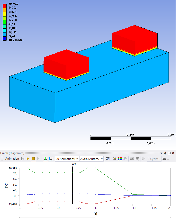

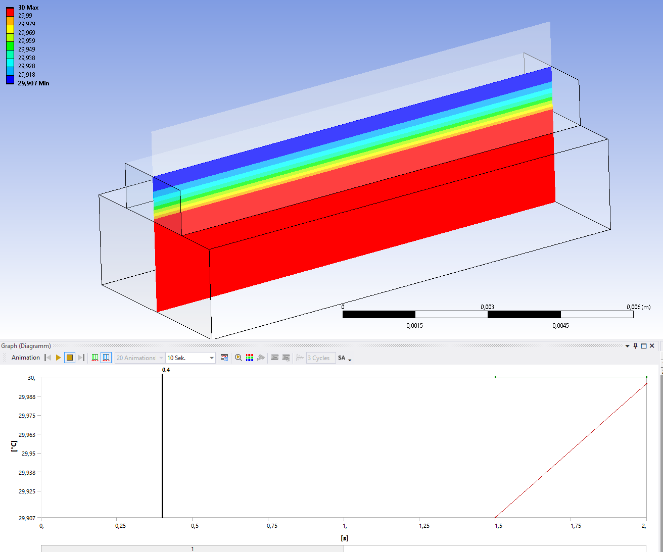

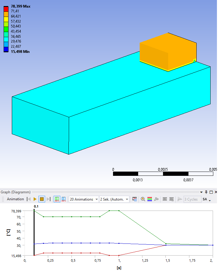

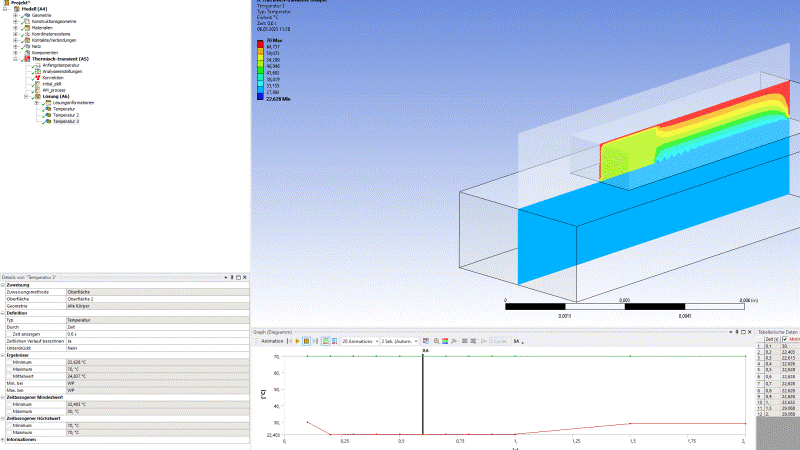

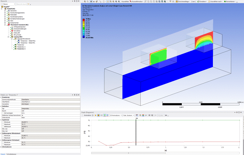

      The first step looks okay:
      The second step is also okay:

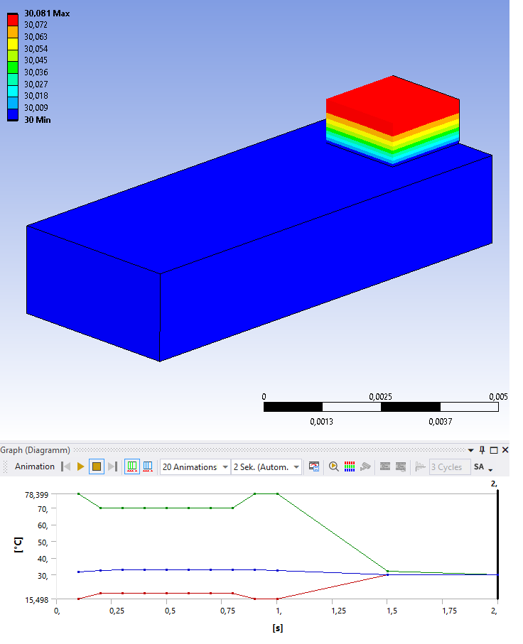

      The third step is wrong, only the first extruded Volume is still alive, and all activated elements of the second step are killed.
      Only the first step is okay and all other steps are wrong. The former extruded elements via ealive are killed. The prep7 is working in every step/load step.

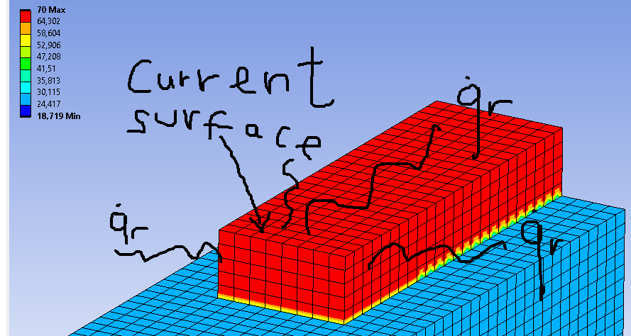

        thank you for your response. You are right, it’s better to stay in /solu, but the model is forcing me to do so. Without leaving the solution, it’s not difficult to achieve a material extrusion for AM Process with the aid of ekill and ealive. I simplified my model to make it more clear how it works.

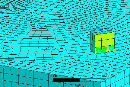

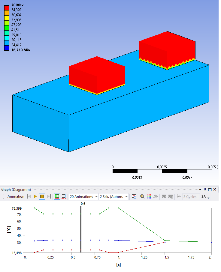

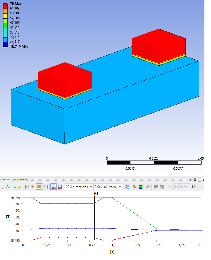

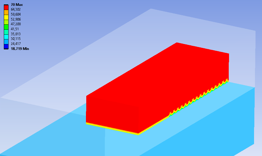

        The Problem with my model is that I need the current surface for radiation application. You can see it in the picture below. During material extrusion via ealive the current surface is constantly changing, which makes it difficult to use the GUI radiation dialogue. For this, you can use only the final exterior surface, but this is not the exterior surface during the material extrusion. During extrusion with ealive the inner elements/nodes become currently exterior and after a few lines interior.

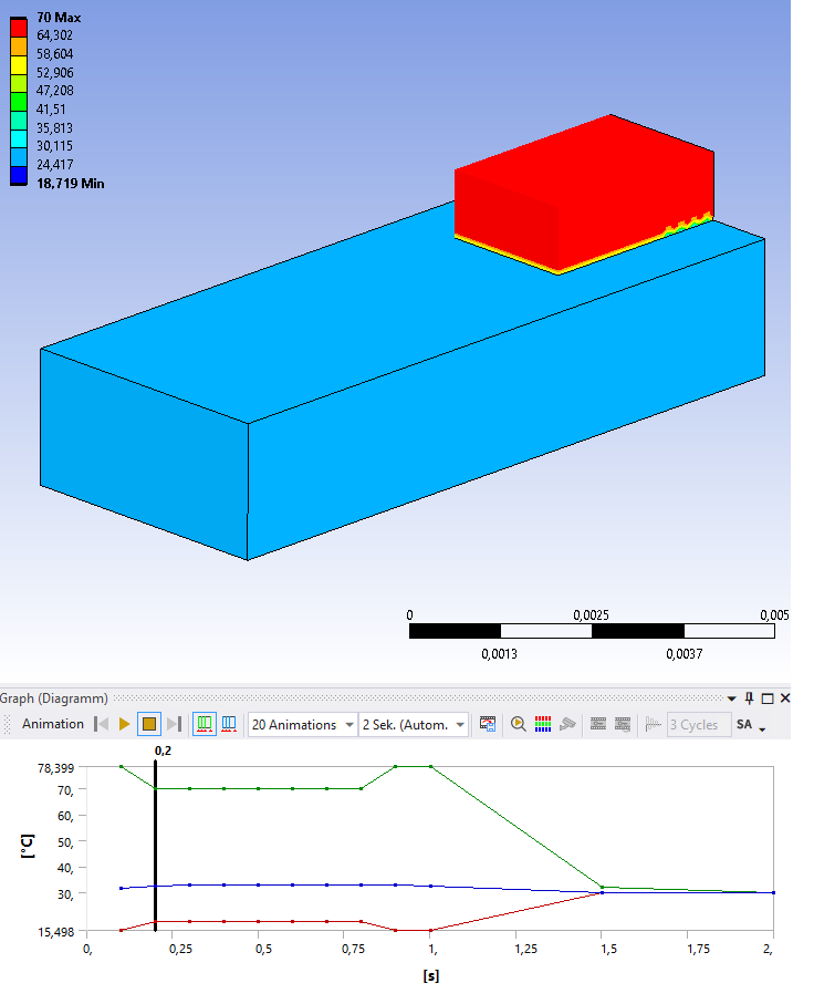

        Without restarting it looks like this (for the 6th time step):
        With restart that’s the result (for the 6th time step):

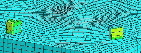

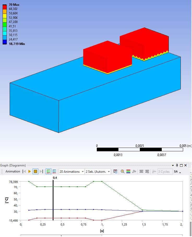

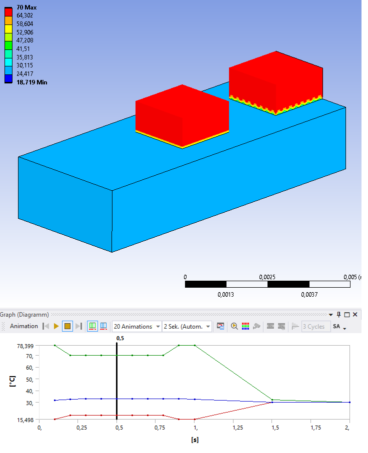

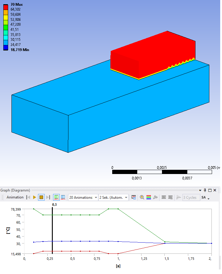

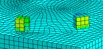

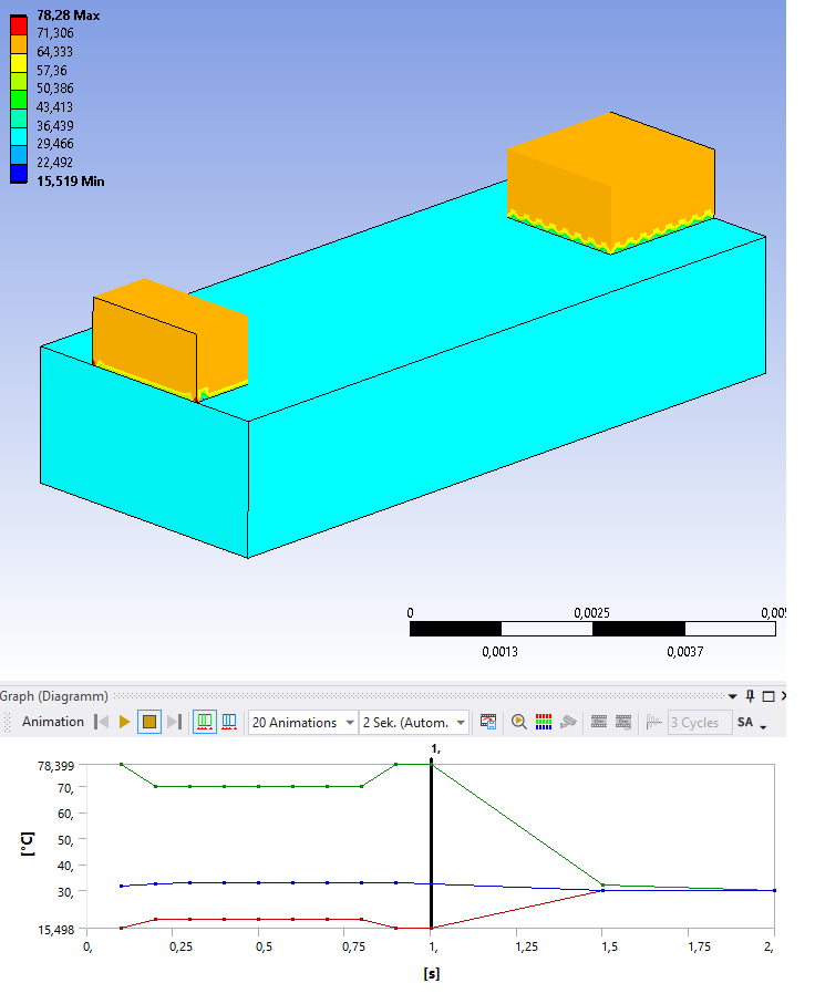

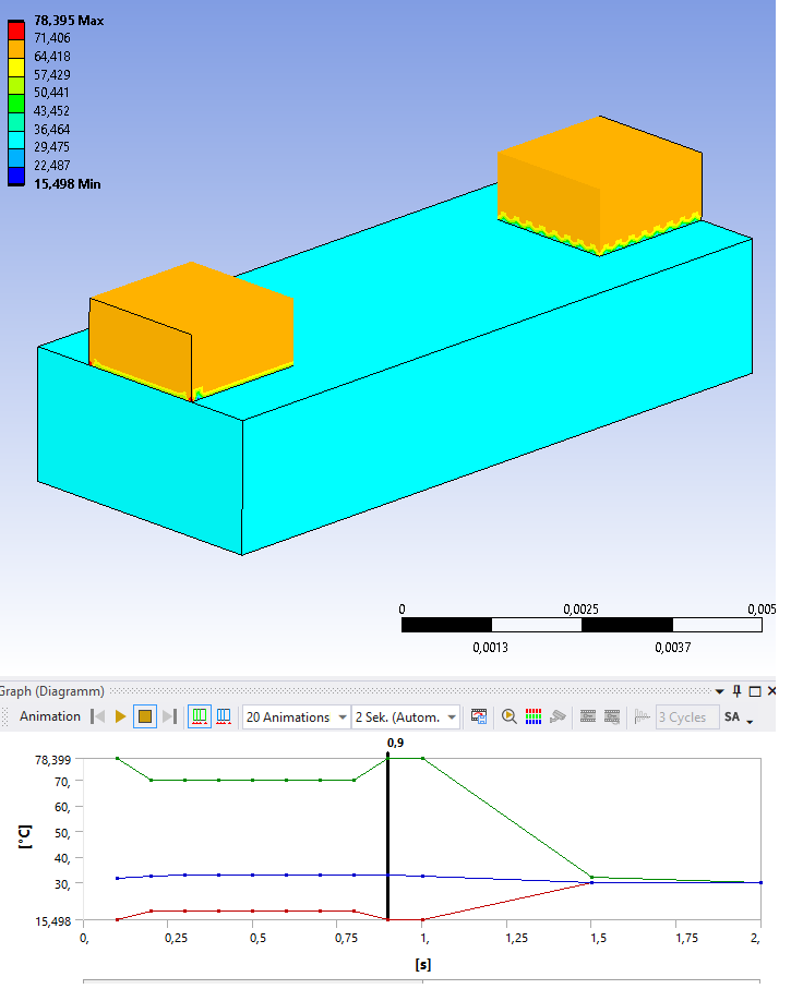

        If I plot the Temperature of the AM process I discovered something strange, the first three time steps are looking good. Material is extruded and then with the 4th time step the activation of the elements is no longer correct, suddenly elements are deleted again. I do not understand why
        Step 1
        Step 2
        Step 3
        Step 4
        Step 5
        Step 6
        Step 7
        Step 8
        Step 9
        Step 10
        Step 11
        Step 12
        With best regards
        John
    • dlooman
      So the process is to gradually ealive additional elements, but starting in load step 4 some of them go back to being dead?  I've never seen that happen on it's own, but perhaps the restart issue I mentioned could set the status of an element back to a previous status.
