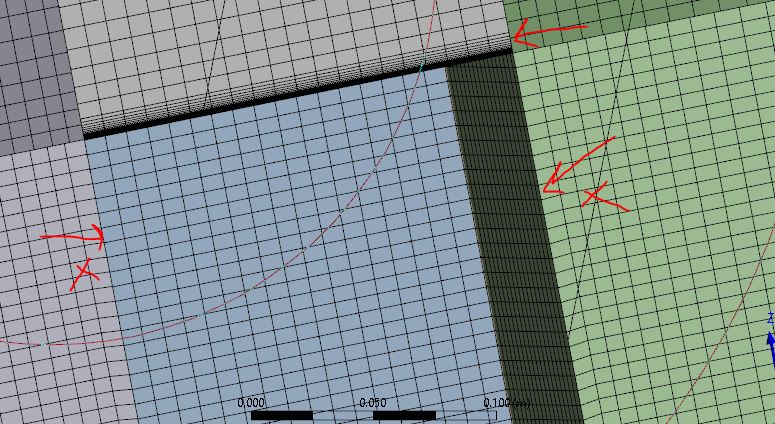

      I am modeling a building inside a fluid domain to test the effect of wind on it, I generated a structured mesh and it has a reasonable quality but when I add the inflation layers to the intended surfaces the element quality of these surfaces decreases and the aspect ratio increases. The other quality measures are alright orthogonal value 0.38, max skewness 0.5
      I am not getting a convergence so I thought that might be the case, any ideas?

      If you are using k-e eht, then please make sure that you have refined mesh near walls.
      what is inlet velocity?
      can you please insert image of mesh near wall.
      you should have good boundary layer / inflation.

      I think the mesh near the walls has an issue, although the minimum orthogonal quality increased when I refined the mesh to become 0.7 the inflation layers are not showing in the intended faces except for one as shown in the attached pictures. All crosses in the pictures should have inflation layers similar to the one in the top of the building
      The inflation layers reappear when I use the same number of division on all edges but that reduces the quality measures i.e. orthogonal around 2e-2
      My inlet velocity is 14.5 m/s resulting in Re around 1.8e5
    • Keyur Kanade
      With inflation 2e-2 is not that bad quality. I think you may proceed to run.
      Keyur
