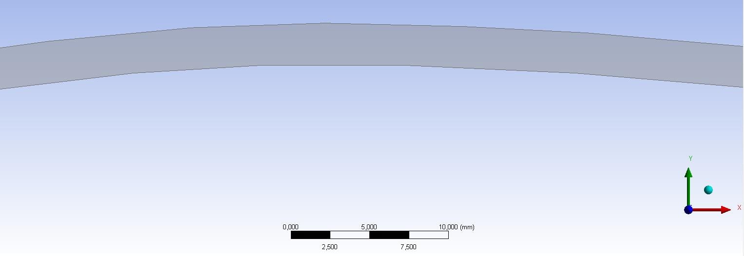

i´ve already built a Model to simulate Drag and Lift of an Airfoil (Gö417A) at a chord-length of 90 mm. I´ve already separated the Mesh in three different regions.
First is relatively coarse (Multizone with 10 mm Hexa-Mesh) and presents the most distant part in relation to the Airfoil.
Second is a cylinder around the Airfoil (Body of Influence, Element Size 1 mm) and has a Diameter of 200 mm.
The third part is represented by an inflation (First Layer height 0.15 mm, 12 Layers and a growth rate of 1.15) and edge sizing (100 Divisions) of the 2 airfoil edges (upper and lower edge).Â
At the leading edge the Mesh does not follow the edge of the Airfoil and creates, in my opinion, a bad quality mesh. Furthermore the solution fails with a non-zero exit code of : 2. I don´t know if the mesh is the reason for the exit code, too.
Does anyone have a solution to make the inflation follow the edge?

Forum ModeratorThat's impressive. Suppress the edge sizing and use the curvature size function. Are there any short edges in that region, and have you got all the edges in the inflation setting?
March 23, 2020 at 4:23 pm
Manu19
SubscriberThe curvature size function helps until the inflation is unsuppressed
Could it be that the imported Step-Model consists of too less X/Y Points? If the Inflation is suppressed it looks like thisÂ
And after unsuppressing there is a part of the inflation inside the airfoil
I don´t know if it´s possible to change the inflation?

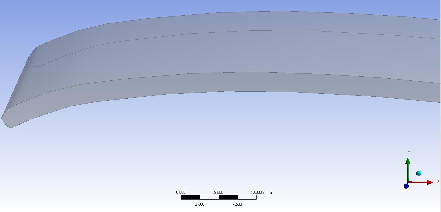

SubscriberThe mesh over the profile is going to be refined if the inflation works. The whole surface of the aerofoil is highlighted. What do you mean how it looks like in the geometry tool? The airfoil itself is imported via Step-model.

The simulation is in 3D. But i think that your suggestion should help, too? The difference between 2D and 3D should only be that i have to choose the airfoil area (3D) instead of the edge (2D) in inflation? Please correct me if i´m wrong. I tried your suggestion but it did not help. I don´t know if i did something wrong?
This is how the airfoil looks in Design Modeler. The Geometry should be OK?
March 30, 2020 at 7:26 am
Keyur Kanade
Ansys Employeefor better mesh please split the curved surface at the leading edge so that you get one upper surface and one lower surface.Â
