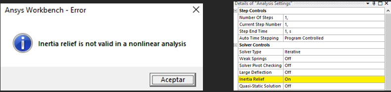

      I was doing a simulation yesterday applying Inertial Relief and at night the computer was updated and erased all the information. When I got back to the office and ran the simulation again, I got an error that I cannot apply Inertial Relief in a non-linear analysis. I don't see the point since I have done several simulations of this style having nonlinear contacts with frictionless contacts and I have never had a problem. Could you tell me what could be happening? It is a model that is coupled with Frictionless and Bonded and the loads they have are the ones coming from Fluent.

      This option applies only to the linear static structural analyses. However, you mentioned that you have applied Inertia Relief in previous similar simulations that had nonlinear contacts. Can you try to compare the model setup that was running and the one you are running now and see if something has changed in the model setup? I have attached the Ansys help link for your help.

        I saw that i had bonded connection only previously and about the simulation which I run yesterday now I'm not sure.
        If Inertia Relief is only for lineal analysis and not for non-lineal analysis, how I could simulate my non-lineal analysis using something similar to Inertial Relief such as making fixed the centre of gravity?
        I can not share the project because it's confidential but we could suppose that I'm simulating a Drone in Static Analysis and I have frictionless contact so I can not apply the inertial relief. How could I simulate this model in Ansys Static Structural without fixed supports because my model is free of constrain in the simulation during the flight appliying the fluent pressure in this static analysis?

    • Akshay Maniyar
      Hi Marcos,
      If you are using inertia relief just to satisfy equilibrium in a not fully constrained model weak springs are an alternative.  Also, a short transient analysis might provide some features similar to inertia relief, as it accounts for the inertial terms, velocities, and accelerations of the model.

        • Marcos Garcia
          Hi!
          I've  already used the Weak Springs with a very low Stiffness (0.1 N/mm) and my model is working pretty good and the results are as expected.
          Thanks so much.
          Marcos.
