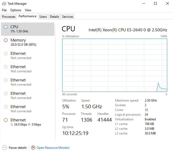

SubscriberI'm wondering if there is a way to increase the speed of Mechanical when it generates my meshing?
I joined a picture of my task manager when I run my meshing and I have ANSYS 19.2.
Maybe there is a way to allow Mechanical to use more logical processors? (I succeded in Fluent set up but not in Mechanical)
Thanks a lot!
December 11, 2018 at 11:19 am
Rob
Forum ModeratorIf you have multiple parts parallel may help, however in this case you may be short of RAM: check for other process and close if possible. Also check how many local mesh settings you've added as you may be over complicating things: we'd need images to see this.Â
