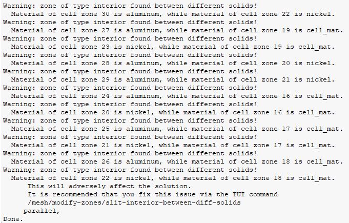

SubscriberI have some issues with the thermal models of pouch cells in serie configuration. As example the thermal model of 4 battery pouch cells in series has exactly the same maximum temperature as one cell. Also cell 1 & 4 in the battery pack should be the same whilst the two cells in the middle (cell 2&3) should be hotter because the accumulated heat in the middle of the pack is more difficult to dissipate.
What I am doing wrong? Reviewed my project several times but can't find any issues. Only thing I'm not sure about is: do I need to define the areas between the cells as air?
I do get this warnings and I already did run the command "/mesh/modify-zones/slit-interior-between-diff-solids parallel" but it doesn't change the models.

Ansys EmployeeThanks for the additional information.
From the last two images you shared it is clear that there is a physical gap between the cells being modelled. And this gap is not meshed and so not modelled - hence this means conduction cannot be accounted since there is no mesh in the gap.Â
So either:
- mesh the gap in between the cells and model the air (accurate and solver works out heat transfer to/from the air gap) - make sure to have at least 3 prism layers close to the battery cell faces)
or
- you modify the thermal boundary conditions of cells faces that are facing each other to have have lower heat transfer which is what would happen as the heat transfer coefficient and air temperature in between cells will be higher.
First option makes good sense in your case as in the other option you will have to somehow try to find suitable heat transfer coefficient and air temperature values which will need to be approximate somehow as these are not typically availableÂ

SubscriberThanks Spatel.
I did mesh the gap between the cells and this solved the issue. Unfortunately this isn't covered in the tutorial. You can see the result below:
But I don't really understand why we have to do this. If the air between the cells needs to be meshed, why the air on the outside of the cells doesn't need a mesh?Â

Forum ModeratorOn the outside of a cell we can add an external HTC and temperature, between the cells (I assume) you're expecting to see heat transfer so we need to include that in the model.Â
