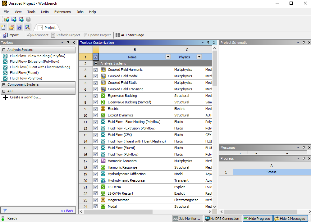

      Hello, my toolbox doen't work properly as you can see in the screenshot. I've seen the same type of issue solved on forums but for older versions, and it doesn't work when I try their solutions.
      Any idea about how can i have all my tools set up properly ?
      Thanks in advance.
      Max
      That looks like the licence hasn't been picked up, ie you've got software installed but the Toolbox list is only what is licenced. Are you using Student or a University supplied version of the software?
    • Gabriel de Araujo

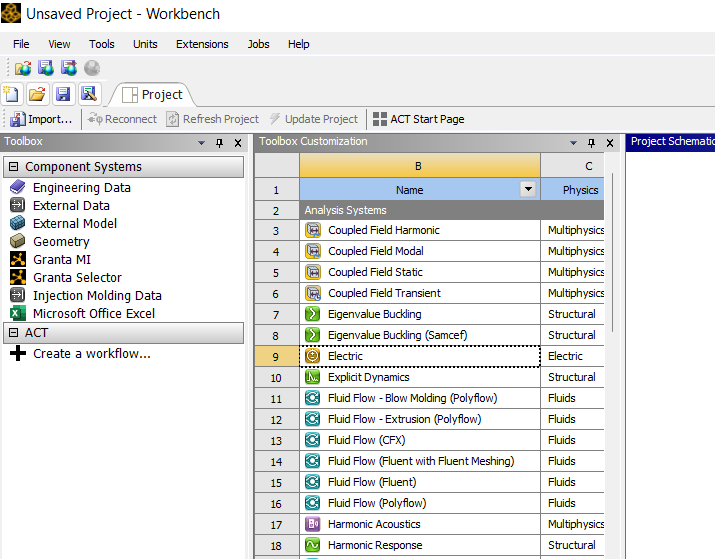

      Does anyone know how to solve this problem? I'm going through a similar situation
      Same question as I asked the OP.
    • Gabriel de Araujo
      I'm using a University supplied version of the software
      OK, thanks. In which case your computer isn't seeing the licence manager. Did you install that, and then connect to the campus licence server?
