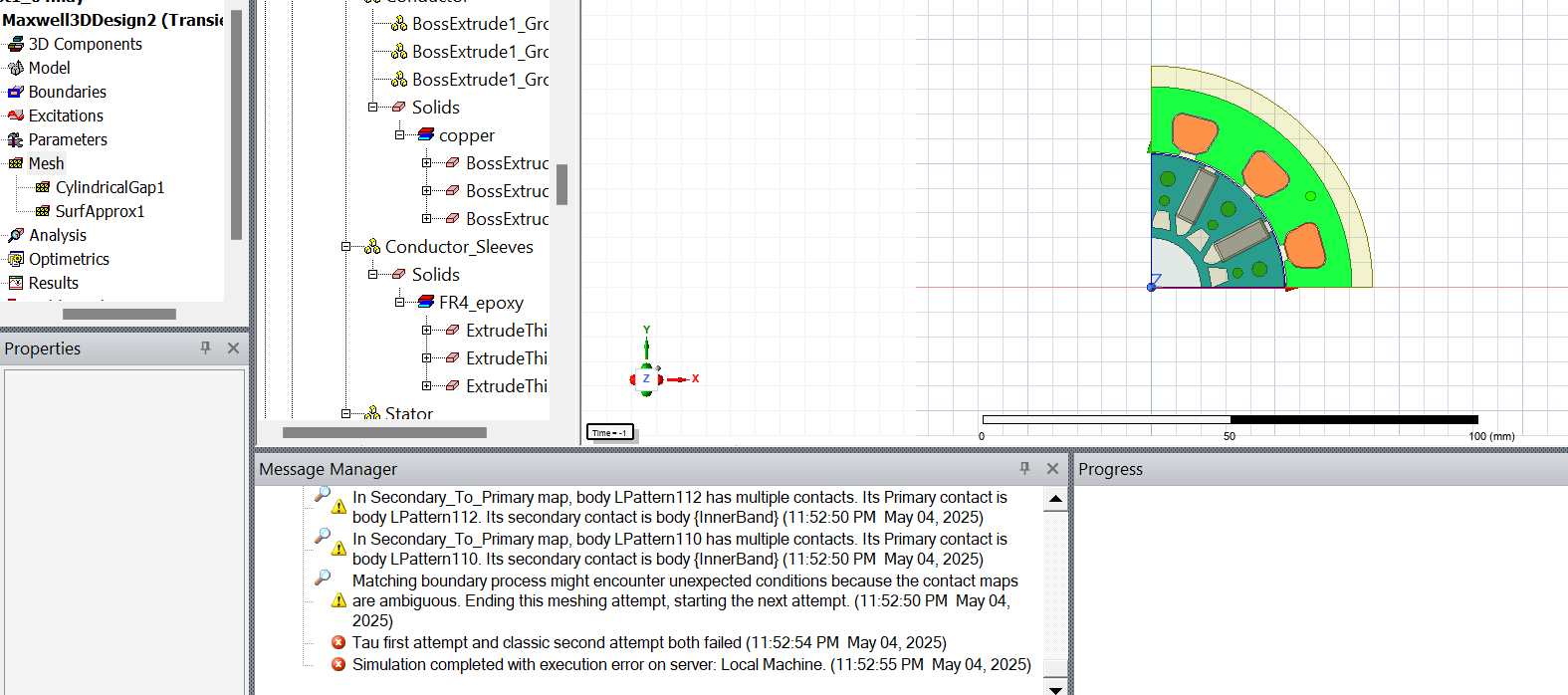

        I'm performing an transient simulation for a IPM and facing issues in meshing. Unable to decode the error. Do you have any idea regarding this error. Attaching the image for reference.
