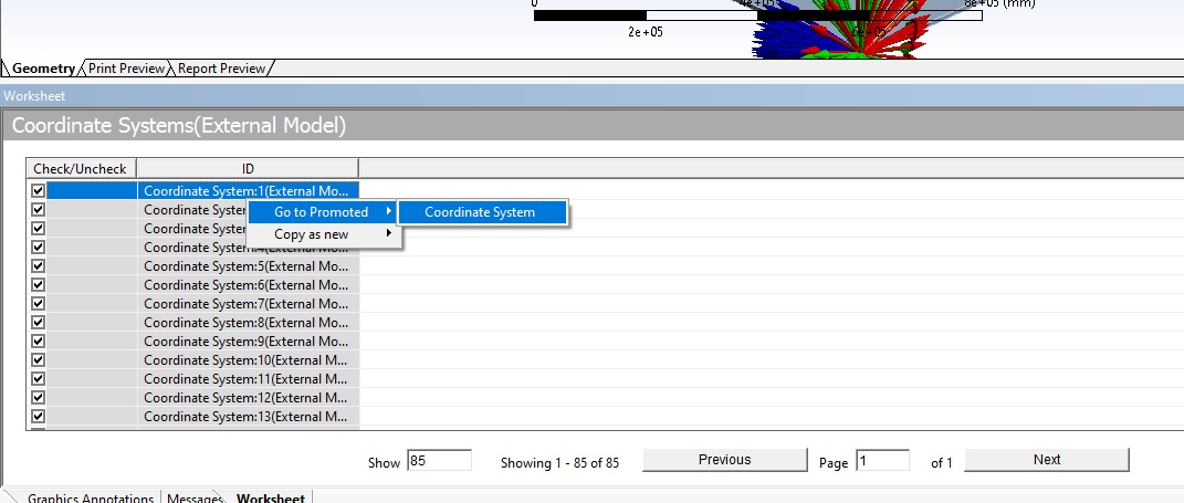

      I would like some help with importing data from an Abaqus *.inp file through the external model in ANSYS Workbench into ANSYS Mechanical. My aim is to read in nodes and elements with local coordinate systems associated with certain groups of elements to implement anisotropic materials behavior.

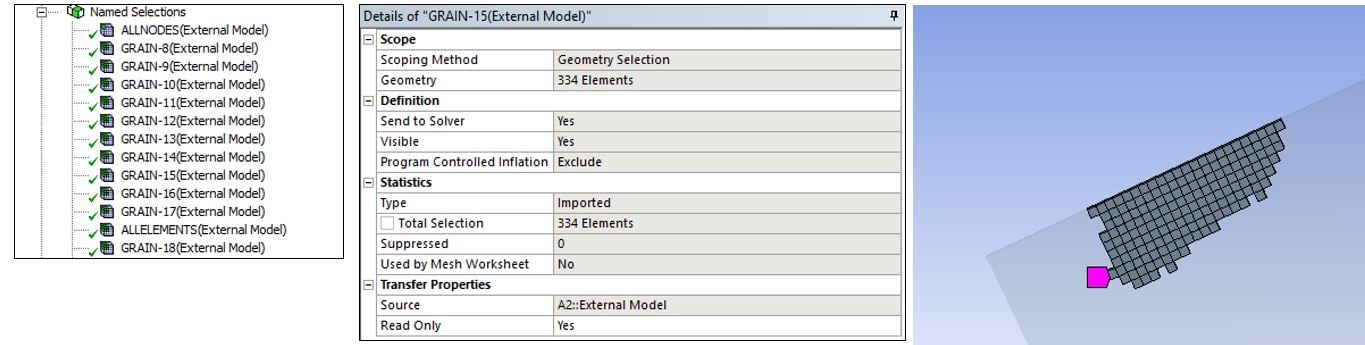

      I succeeded in importing nodes and elements with named selections of element groups. I also managed to import local coordinate systems that I need for each named selection to define anisotropic material properties.
      Here is one of the local imported coordinate systems:
      This is one of the named selections, that groups a number of elements:
      I would like to be able to assign an anisotropic material to the entire plate (that's easy) and then use local coordinate systems to define the orientation of element groups. This does not seem to be possible.

      I was unfortunately not successful in importing local coordinate systems that are directly associated to the named selections in ANSYS Mechanical.
      But even worse, the named selections in ANSYS Mechanical do not seem to be useful either. If I, for example, want to do a material assignment to a named selection, the dropdown window is empty even though I have all the named selections from the element sets.
      Does anybody have a clue on what to do about this situation? Any way forward or alternative approach would be great. I am currently generating the *.inp file in MATLAB and could formulate it differently if there was any merit to it.

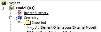

      I finally figured out how to import Element Sets with a local coordinate system with an Abaqus *.inp file:
      Define the local coordinate system:
      *ORIENTATION, NAME=CS-50, SYSTEM=RECTANGULAR, DEFINITION=COORDINATES
      0.,-0.02357,0.85587,-0.51665,-0.98928,0.05454,0.13547,0.14412,
      0.51431,0.84541
      Define the element set:
      *ELSET=Grain-50
      2698, 2699, 2769, 2770, 2771, 2772, 2773, 2774, 2841
      2842, 2843, 2844, 2845, 2846, 2847, 2914, 2915, 2916
      2917, 2918, 2919, 2987, 2988, 2989, 2990, 2991, 2992
      3060, 3061, 3062,
      Define a shell section, linking the element set to the local coordinate system:
      *SHELL SECTION, ELSET=Grain-50, ORIENTATION=CS-50
      Finally, the element orientations can be imported with the external model and will show up in the Geometry tree:
      Thank you all for your help.
