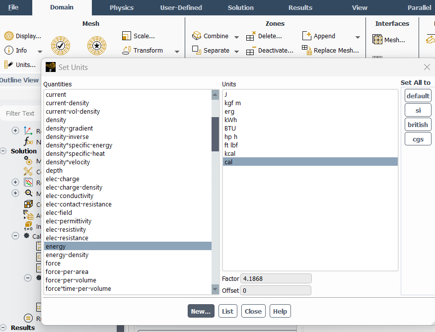

Subscriber- Hi..I am Wimukthi. At the moment I am modelling hydrogen-oxygen combustion in ansys fluent. My model is a 2D half circle on ground filled with oxygen and air mixture. For that I have to import Chemkin reaction file to ansys fluent. However, Chemkin has different units for pre-exponential factor (mol/cm*sec*K) and Activation energy in the rate constant of the reaction [cal /mole]. I wonder whether I have to change the units of coefficients in the Chemkin code. Or will it work if I change the units in Ansys Fluent to match with Chemkin default units as shown below:

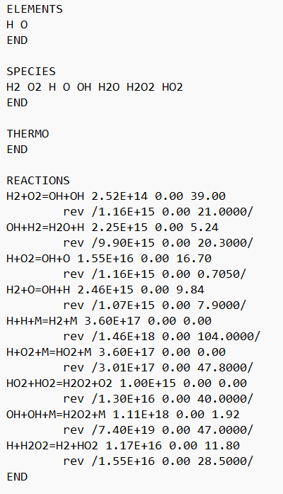

2. Recently I used the following code for hydrogen oxygen reaction. I wonder whether it gives correct results:

Ansys EmployeeHi Wimukthi, Please find below the response to your queries.
1). You dont have to convert the units. Fluent does it for you. The unit of Pre-exponential factor depends on the order of reaction + the unit of K appears in pre-exponetial factor only if Temp exponent is present.
2) You can refer the CHEMKIN Input Manual to verify the syntax used. At a first glance, I dont see any issue with your mechanism code.
3) When you enable reaction modelling using species transport (a mixture template gets created) with the species in the imported mechanism. You can initailize your 2D domain with the mass fraction of H2 and air as per your choise. You can patch a high temperature within your domain to initiate combustion.
